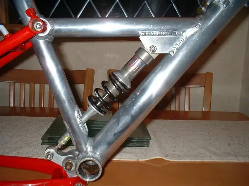

RTS main pivot bolt , top left , cant see it in the finished frame as i got some caps covering it

looks as though it should be m8
and from the pics i have can't see if its nutted but i imagine it will be
(as opposed to the other side being tapped)
now don't quote me on this but if you ream this 8 mm the bolt should
pass through fine, an 8mm drill used with care may do the same
disclaimer
i credit you with enough sense to do this properly if you
balls it up then its your own bloody fault.
mike
