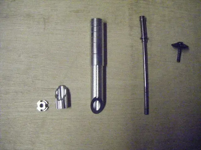

I've used http://www.bicyclerepair.co.uk/shop/3/115/index.htm for both 1" & 1 1/8" .
I've posted a sequence here. http://flickr.com/photos/31796519@N07/
Chain Reaction do 1 1/8" here http://www.chainreactioncycles.com/Models.aspx?ModelID=3970
The bolt is in 2 parts. The bottom part secures the wedge. The headcap bolt then screws into this to load the headset bearings. In use you wouldn't know it's there.

Thanks for all the info and pictures. I am now convinced and can see that one of these could be very useful.

Thanks 4 posting the pics up Faceplant :D .............will help a few people i think .............
