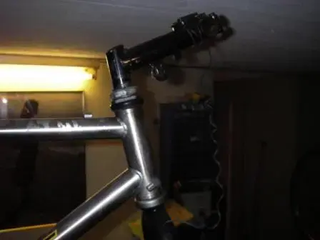

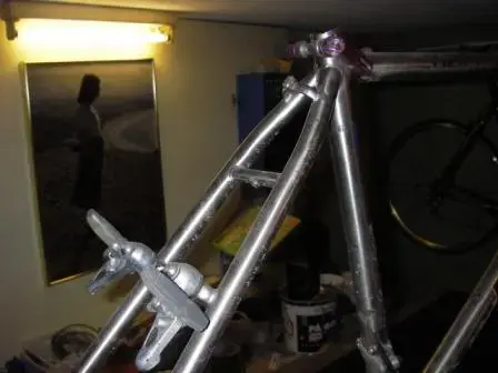

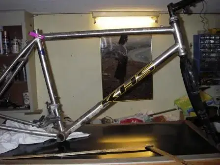

Been offered this frame, it's marked khs but that's just for shows. It's a Marin, but what model is it? it looks pretty high end. I think the year on this would be early 90's but I'm not sure.
I also need to be sure that it's 1 1/8 fork dimension? it seems that they have had that as standard for a long time. I need to know cause I have a fork that I want to put on it, and I want to use Ahead on it...
it looks like a pretty good frame, with some work could be a nice retro xc race rocket!

Looks very much like my Marin Team Issue which is a 1993 and does indeed have a 1 1/8th headtube.
Are there any clues to the tubes used as that would help a lot to identify it, but think you should be safe with your forks

i'd agree. Never seen anything other than a team issue/marin with the cable stops on the side of the headtube but i may be wrong

that's what I expected...
Sure If I get it, I'll try to ship the qr to you from sweden.
do u know the seatpost dimension? I'm thinking of a thomson finnishing kit. Have a seatpost in 27.2
a judy (or maybe a sid) would be just fine on that one don't u think?

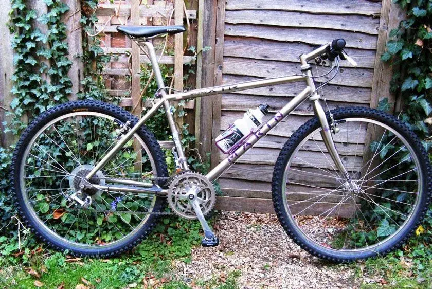

Now back to business, the seatpost on mine is a 26.4mm and you might get away with a Judy or a Sid if its got about max 50-60mm travel
They came originally with a rigid fork and the suspension option was a Manitou 2 which had about 45mm of travel
Looks like the original stem on there with the roller, reckon it could be either the Team or the Team Issue frame, one had Tange Prestige/XT and the other Tange Ultimate/XTR
This is mine back to the original spec apart from the seat Q/R.
I also have scans of both the catalogue pages for the bikes if you do decide to go ahead
If you need any more info I will do my best to help out
Cheers
Rich

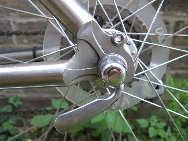

Think the dropouts confirm your belief that its a Marin Team as do the cable hanger and bridge.
Very nice frames and sure it would make the basis of a great build
