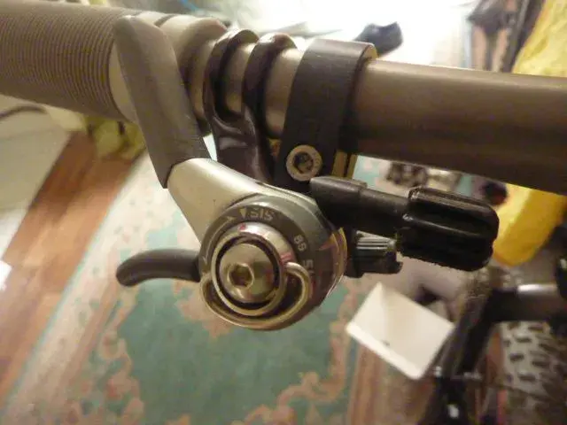

Pauls thumbies with Shimano ultegra 8 speed bar end shifters
Wow! They’re modern! They’re even wireless!
