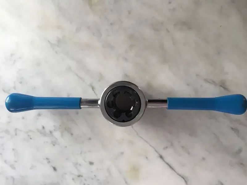

I bought a VAR Headset fork threading tool on ebay. I got a good deal on it, problem is I can't find out how it works. This is an older, vintage tool, however VAR is a reputable brand so it should be designed to do its job.
The tool should have an expanding screw to make the tap die wider or narrower but the screw that's in it right now has no effect. It does not widen or narrows down the die. I tried on an unthreaded fork, 1-1/8" diameter head tube, and it does not go over the tube even though it is marked 1-1/8 and 26 pitch which should be for 1 1/8 steerer tubes.
The main problem is I can't get the thread started. The tool won't go over the the steerer tube. I am getting ready to return it but it may be that I just don't know how to use it. I attached photographs. I suspect this may be rookie error. I have never used a fork threading tool so this is my first time trying to thread a fork steerer tube.

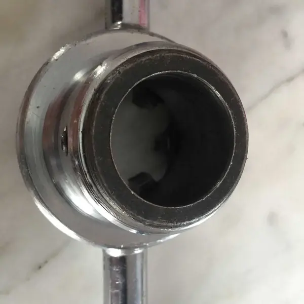

Pic 2 shows the part that goes over the steerer first, which guides it centrally and square to the tube.

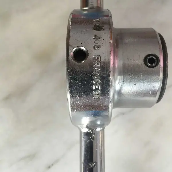

Pic 3 shows that the die is upside down, the detail info should face the cutting to be done and there is a split in it that needs positioning with a grub screw that has a 90 deg point to it, as that is how the adjustment is done to obtain the correct size.

Thank you for all the suggestions. I'll flip the die over, cut a chamfer (I have not so far) and try the other tips. The grub screw looks like it serves no purpose as it is now. Shouldn't it be fluted, meanting larger at one end than the other? Pointed at 90 degrees as you say. Mine is straight, same diameter throughout.

Does picture 2 show the chamfer on the inside of the die to help guide the die in the tube? BITD we used a lot of oil, we also used to cut a quarter turn at a time and back out, just out of curiosity has it changed ?
