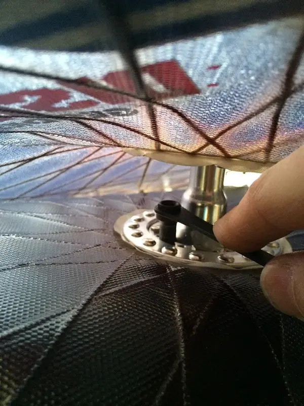

Is there a definitive guide on Retrobike of how to build / true a Disk Drive? I'm surprised noone has created one yet (with pics).
Scouring the Search and there isn't anything very informative.
Exactly the same principles as building a spoked wheel, Jeremy.
Built one two years ago and have another one to build soon. Well, I supervised a wheelbuilder building mine two years ago... Just needs a Philips scredriver to turn the nipples from inside the rim opposed to a tightening with a spoke key on traditional nipples.
Download the DD instructions from the archive for the order in which to attach the nipples to the discs for best/uniform pretensioning. Then tighten each nipple and true it as per normal wheel.
My only personal advice is to attach the discks to the hub a day before tensioning the discs/nipples to the rim so that the threadlock has good time to cure on the nuts and bolts.
Good luck dude.
When I was truing mine (when I still had one) I had to make a doo-dah to hold the silver button disc steady while I adjusted the nipples. I think there is a proper tool but I didn't have it.
