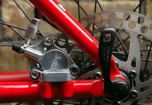

I presume you had something like this:

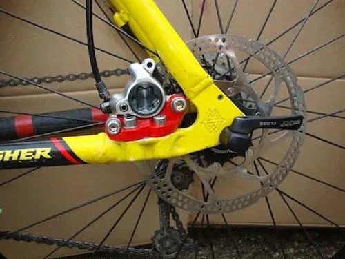

The A-Z AD-PMR should fit with a Magura Marta, Julie or Louise, Formula, older Hope Mono, C2 #3 or similar. This is about the smallest combination you're going to get on an ISO fitting. This is a Marta:
If not, you'll just need to find another C2 caliper. You've come to the right place to dig up that sort of thing :D

Thanks I'll bear them in mind, once I've got the adapter I'll be able to see what will fit, as you can see from Dan's photo abpove there's not a lot of room so some brakes won't fit.
