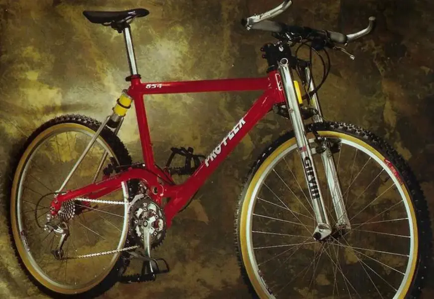

I need some instructions on how to change the front elastomer(s) on my Proflex 854. I have a 45mm and a 35mm elastomer, any help will be greatly appreciated.

[/img]
File comment: Proflex 854 1994

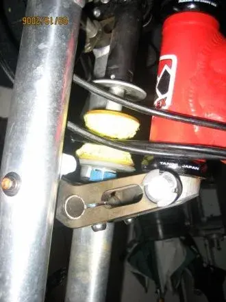

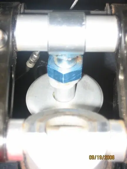

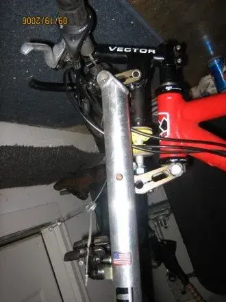

I managed to get the forks apart and get the piece that holds the elastomer free but I could not get it to come out to replace the elastomer.

hmm , vector 1
will have to check on my files , how to get this one out
think i got it worked out but want to be sure
PostPosted: Wed Sep 20, 2006 4:43 pm
BoTM Winner
BoTM Winner
Joined: Sun Oct 09, 2005 8:19 pm
Posts: 2217
Location: S WALES
the only way i can see to get the new elastomers on is to remove the forks completely
headset cap off , slide the stem off and drop the forks out
you should then be able to pull the stem and the bottom linkage in opposite directions
which will pull the elastomer spindle ( silver ) out of the ( black ) part that is attached to the stem
then all being good the elastomers should slide on
the only other way is to start removing the bottom linkage and you will end up with about 3 million parts on your table
try it and let me know
