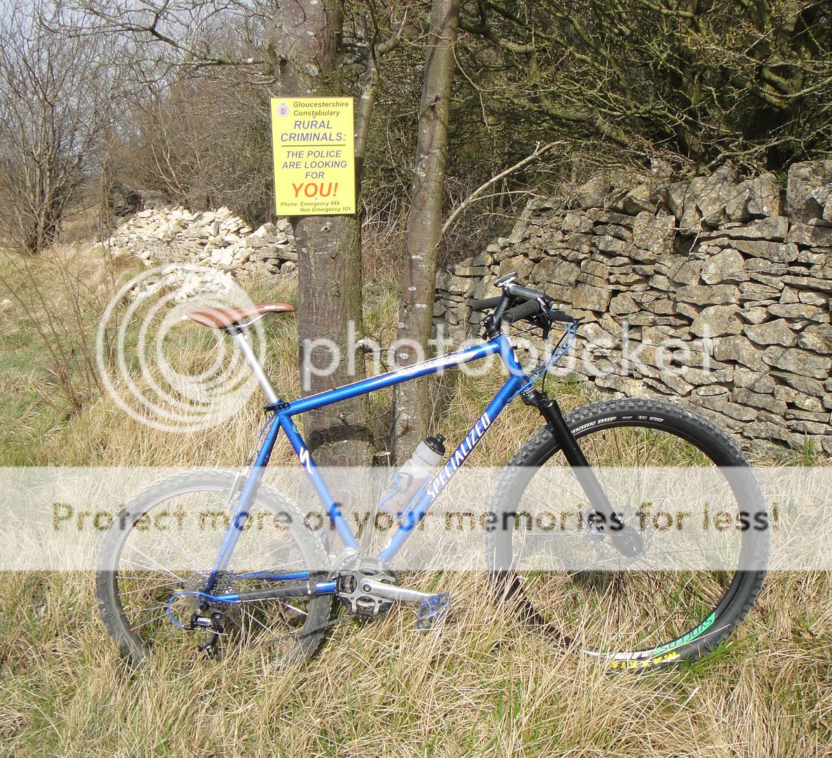

Good Grief HM, that bike must have "interesting" handling characteristics - please tell me it's not yours :shock:

Of course it’s mine, who else would build such an innovative steed? It did did have interesting entertaining handling, dropping into turns, skittering a little at the front etc. If you want predictable normal handling I’d say don’t mess with the geometry. But who wants normal?
As for getting caught, it was a master of disguise and was raced before the frame was snapped up by a discerning buyer at mayhem last year.
Yes I know. Sorry, I don’t do commissions.
