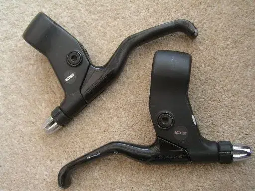

Got some of the pictured levers ..........
where the cable goes into the adjuster seems to be massive compared to the cable ( 5 mm )
the adjuster must be about 8 / 9 mm , makes the cable look really loose in there
is this normal ? seems rather large
always used shifters / levers so no idea if this is ok
thanks slim

Back in the days the SLR cable was much thicker, hence a bigger outer cable, so yes its normal if your using the new SLR cable.
:idea: You can still buy the old xt stuff off ebay.com :idea:

this is what i was thinking , but what thickness was the old cable ?
got some old cable off the pine mountain and even this looks small ?
suppose i could swap the adjusters out ?

The old cables also had a plastic coating around the barrel, so it fits perfectly in the hole. I have a pair on my Nishiki. I bought them in a shop (old stock and a bit dusty) only to find out I already had a set in my basement :?
No probs of course...new projects will arrive :)
took some pics for you...
