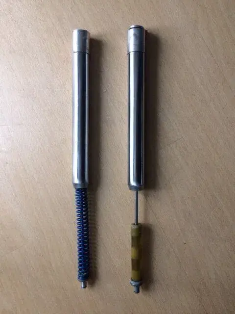

Recently my Pace fork started to feel a bit sloppy, still some travel, but not as much as there was before, and what there was used up quickly...
I should note its a RC35 with a CNC'd brace and an adjustable damper in the right leg, bought
Stripped it down - and in the right hand leg with the damper is an elastomer stack, (yellow and natural) with a couple of them crushed into pieces - so good so far.
Then I stripped the left leg and found a blue spring ? Now that I wasn't expecting.....
Any idea how this fork got a spring ? doesn't look home made or adapted, thought all forks of this age were elastomer ?
Spring looks to be in great condition, so I plan to replace a couple of elastomers and rebuild - anyone got a couple of elastomers for sale ? also where do i add the new oil to the damper ?
Eh? RC35 was all elastomer, no cartridge or spring. RC36 that came after had no elastomer, but did have springs and a cartridge. Sounds like someone has had a go at experimenting with the fork, or maybe it's a secret experimental model! :Do Any photos?
The rc35 mx range had dampers and elastomers. as it has a damper you can in theory replace them with springs which it sounds like has been done here.
It seems mine is a hybrid of the two - with a stack of elastomers on the damped RHS and a sprint on the LHS.

If the spring is progressively wound - that is the coils are closer together at one end than the other - then it's most likely a hard spring from a 97 RC36 MXCD. Quite what it's doing in there though is anybody's guess.
the spring isn't progressive, nor is it multiple springs - its a simple straightforward spring - neatly finished and the right length so seems possible it was factory.
Here's a pic.... the elastomer stack is short because of the ones that have imploded....
