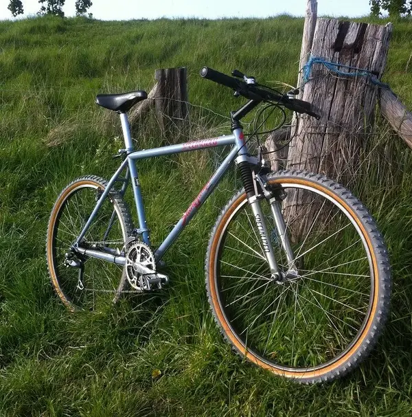

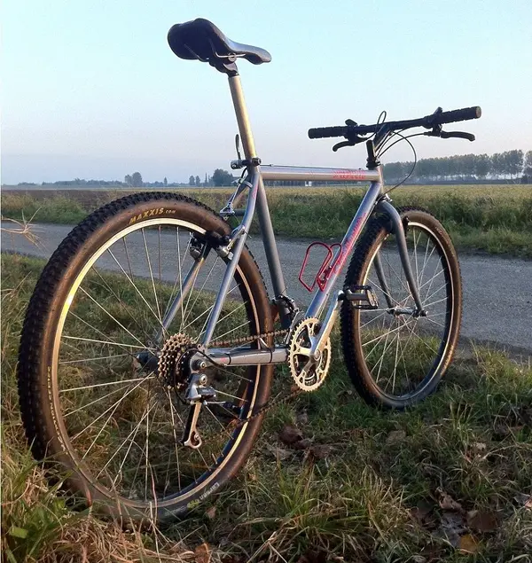

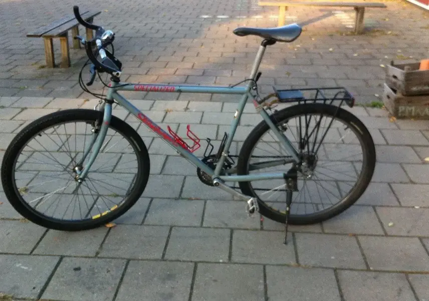

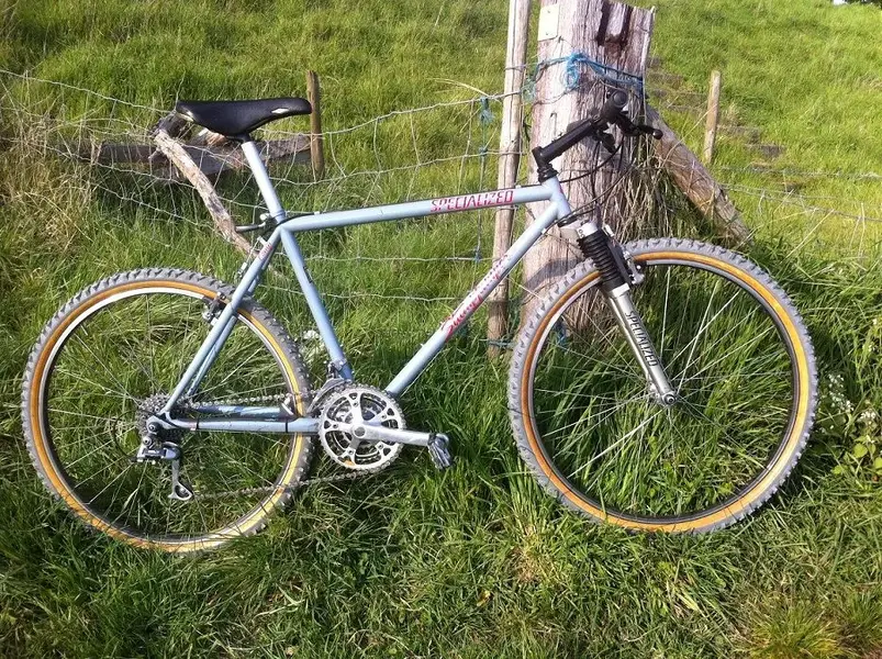

this week my daily search for bike related stuff was rewarded with a stumpjumper for only 30 euro's. The woman I bought it from almost threw it away. Luckily she had owned it for 20 years and has travelled with it trough Morocco and India. It had some sentimal value. After I told that I'm going to restore it she offered to buy the bike back after it is finished.
The only original part left was the headset but the frame and fork were in nice condition. I stripped the bike, cleaned and polished it and the paint came out really nice. Except the wheelset, headset and bottom bracket I replaced everything with parts I had lying around. Still need to do some adjustments but this is it for now, hope you like it.

I'm a vintage Stumpjumper fanatic and I LOVE that color! I would have bought that in a heartbeat.
What are you rebuilding it with for components?
I rebuild the bike with the following components:
pedals, shifters, derailleurs and front hub: deore xt
cranks, rearhub and cantilevers: deore dx
rims: mavic m231cd
brakelevers: dia compe ss5
handlebar: itm superalloy
headset: specialized
saddle: selle italia flite
stem: tioga t-bone
tires: maxxis larsen tt
chain: kmc z1
grips: profile

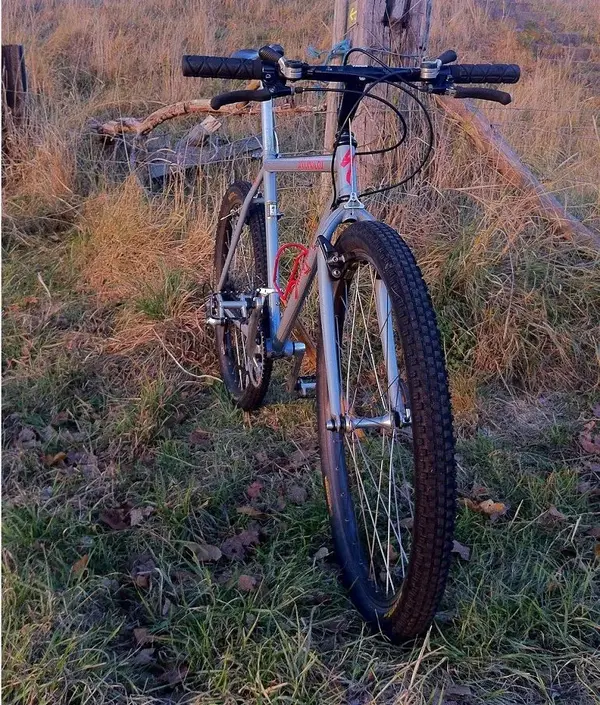

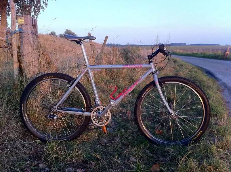

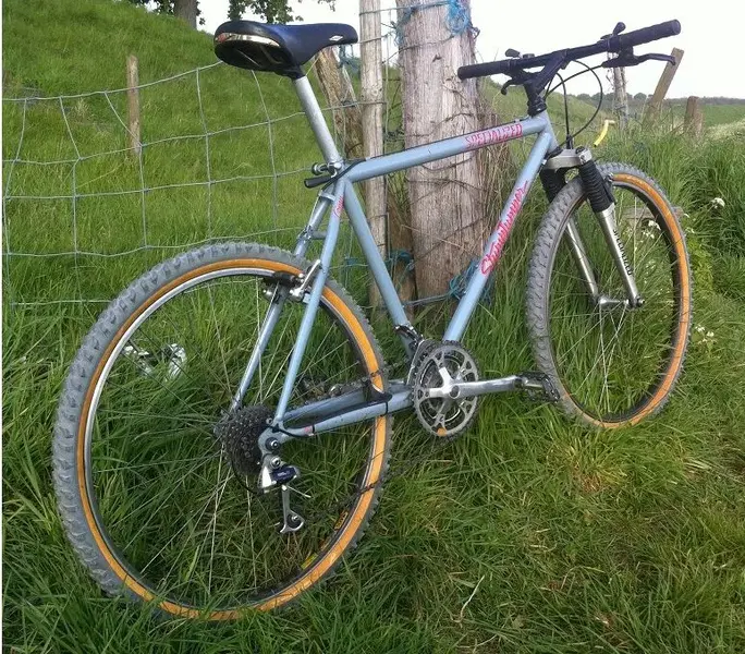

the stumpjumper has had a kind of makeover over the last few months so I thought to update this thread.
what has been changed:
stem -> 'stock' specialized
tyres -> cheng shin (nos up until about 2 hours ago)
brake levers -> shimano M733
seat post qr -> shimano SQ-M730
saddle -> san marco rolls
grips -> onza ules
fork -> specialized futureshock
cheers!
