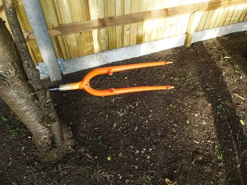

overnight the paint on the forks reacted to some thing so had another go today, still the wrong colour & now with a true handcan finish, I don't know about orange, the finish looks like an orange! So looks like I'll be flatting the lacquar back & popping on a couple more coats.

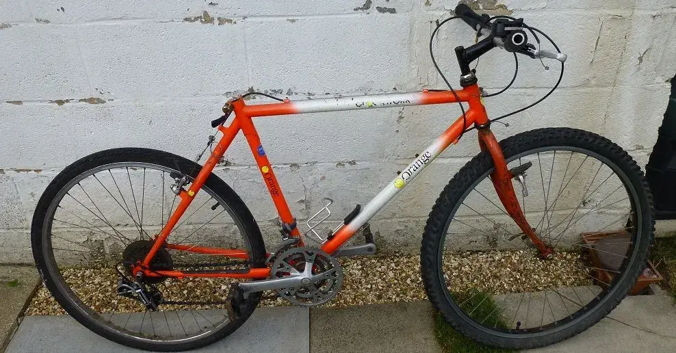

Headset fitted & forks now on, good gracious they are SO the wrong colour but I suppose as bad as they are it's better than flaking paint over rust :lol:
Canti's also on, so need to find a set of black zoom bars or fit it up withthe painted set of hl /nl? bars I have handy.
