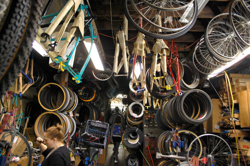

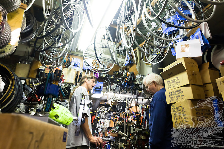

Good! Then you'll stay out of Kraynick's Bike Shop (the best shop in Pittsburgh!) so that I can find and buy all of the good stuff!
In the last year or so, I've bought the following there:
- NOS Mitsuboshi Moab Leader gumwall tires
- NOS 1" Suntour XC Pro headset
- 2 NOS 1-1/8" Joe Murray Impact Headsets
- NOS 1" Joe Murray Impact Headsets
- NOS Odyssey roller bearing headset
- NOS Shimano Silent Clutch hub
- NOS Araya RM-17s
- NOS Hite-Rite
- NOS Rock Shox Judy damper cartridge
- NOS GripShift covers
- Replacement Shimano axles and cones
- Replacement adjustable bottom bracket spindle
^ That's just the stuff that I can remember!
He doesn't take credit or debit cards; only cash or check*.
* And he doesn't have one of those check scanners, he takes them to the bank!
Ooh that looks like an awesome shop :) There is a world of difference between buying things from a cluttered shop vs things manufactured in a dirty workshop. I still remember doing some work experience in a workshop: the chap asked me to do something with acrylic and then hid round the corner to check if I would sweep up the swarf from the workbench before laying the acrylic on it and scratching it.
