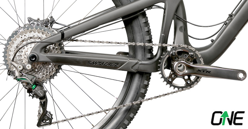

Yes, that is a 48t rear cassette and yes, the person that bought this will tell you that its better than anything else ever ever ever ever. But then they have just spent a lot of money as well and are not likely to say its shit (until the next thing comes along that really brings the trails alive)
But, as a counter argument, many hardly ever shift at the front end and a triple on any MTB was always a bit excessive. The UK scene was originally cross country and for long rides so rarely would a 48t chainring get used.
Front indexing was always going to be awkward due to differing chainlines, mech reach, cable pull between groupsets and that nagging sound of chain scraping on the mech brought many to near insanity.
But, again, many also have no problems whatsoever and look blankly on at those crying over front mech adjustment.
