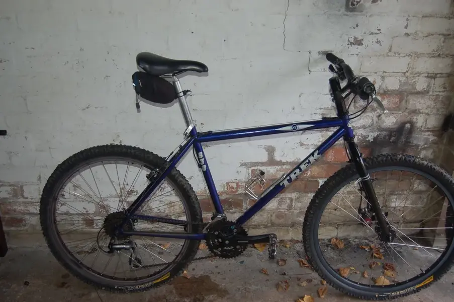

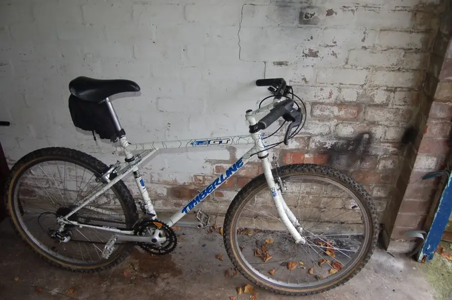

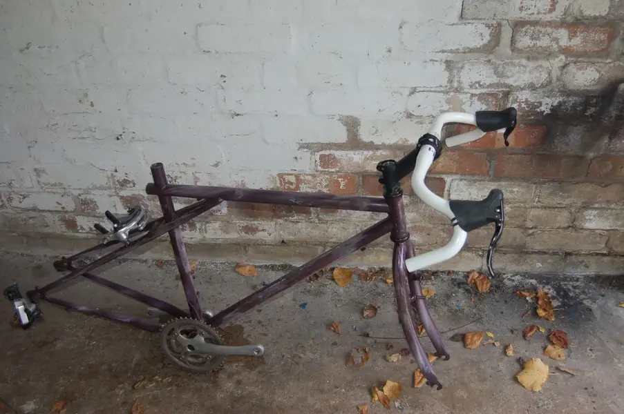

At the moment the Trek is set up as the 'proper' MTB due to it's longer, lower position, but it's the only one with rack mounts... The Timberline is the commuter due to it's worn appearance and plasticky levers = less theft-worthy. The Tequesta is about to be the dirt-drop bar bike unless persuaded otherwise.

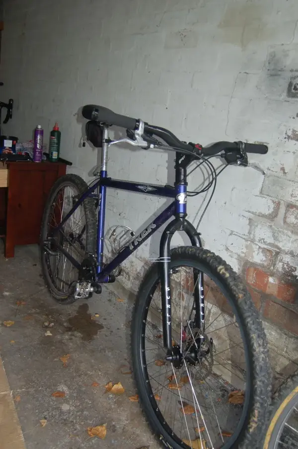

At the moment the Trek has Surly forks and a disc brake, which seems like overkill, but I set that up as the 'dedicated MTB' because it's longer and low than the GTs, so wouldn't suit the drop bars. The GTs have the same effective top tube as my road bike and a quick set up of the Midges on the Timberline felt like a reasonably comfortable reach.

Currently the Trek set up as MTB with Surly forks, disc brake, riser bar, and the GTs waiting to find their fate.

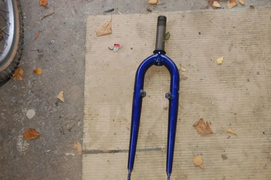

Just for practical reasons the Trek has to be the 'Proper' bike. As putting 425mm front forks on the 92' GT's will change the handling as they are designed for 395mm forks.
As for the GT's dirt drop the Tequesta as this was the higher end bike and will ride better and rat the Timberline.

Just added the Mary Bars to the Timberline - think I love them. And indexed the gears finally. Surprisingly easy despite the mushy plastic shifters.
