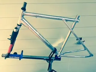

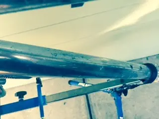

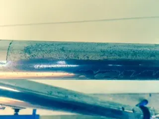

So I have stripped the frame, blasted it with high pressure water and given it the once over with autosol and some elbow grease.
I now was hoping to get your advice on how best to bring the frame back to reasonable condition. Should I hit it with fine steel wool to remove pitting and then finish with autosol and perhaps braso etc?

I made my Zaskar with 800sandpaper, where it has got scratches (next to the chain), and then just Autosol Aluminium, and patience... :D

97 era Avalanche/LE was not a ball burnished frame it was actually anodized in a color called "billet" It will never shine unless you sand it all off and that's a months worth of detail work.

It is ball burnished, the 98 is the "billet" colour..
