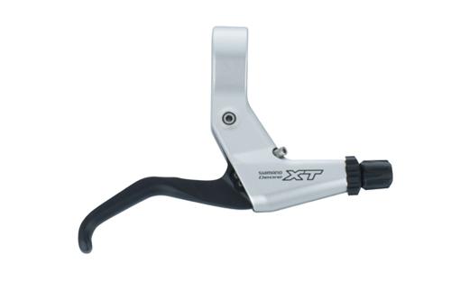

The difference between cantilever and V-brake levers is the distance between the pivot and the cable attachment point.
For example, this is a cantilever brake lever:
This is a V-brake lever:
Notice the extra distance between the lever pivot and the cable attachment point. With a V-brake lever, you get a lot more cable pull for a given amount of lever movement.
