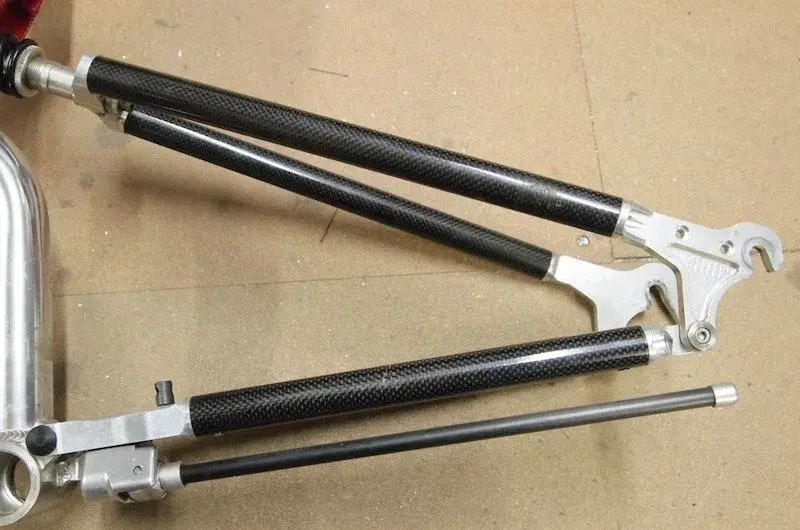

Quote:
Is the carbon rear triangle from the B5 or was it available for the B4 as well?
I don't recall a B5 carbon rear, but here's the carbon version of the later aluminium B4 back end..the one with the bonded crown and dropouts, rather than the earlier welded one. I got mine via a Merc B4 including carbon kickstand :shock:, but it's been de-badged to go on a B4 with a carbon F3 fork too.
I'll own up to 1x B3, 2x B4, 1x Merc B4 and an Italian Extralite B5 copy....+ 2 alu F3 forks, 2x carbon F3 forks and one F4 BLT :facepalm:
Having ridden B3 and B4, I'd go for a B4 with an F3 fork. It looks great, seriously light and gives just enough travel to take the buzz off trails. Don't get it confused with a serious downhill bike, though. XC only. I'd love a (twin downtube) B2 with an F3 fork, but they don't come up very often...any offers?
-There's nothing too weird to stop you running modern gear except the pre-ISO2000 disc brake mounting.
-Adapters are available for running modern ISO or postmount discs, but the AMP/RockShox discs are (just about) OK if you want to run all original.
-Some frames and forks came with canti mounts (either welded or clamp-on) so you can run rim brakes if you want.
-Try to get a Risse air shock (Genesis?) if you can, The AMP coil over shock isn't great, and Kevin at Risse will still service them.
