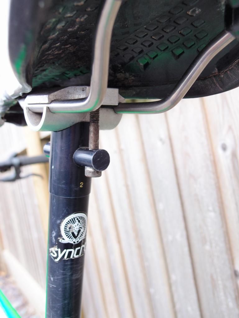

I bought this 26.8 back in 1990, its seen a lot of action and is very slightly bent. but still in use.
The blue anodizing was done in 93.
My one seems to be inbetween yours and the one in the image posted by fluffychicken
excuse the offending tioga post.

So if I understand it correct, there was an earlier Syncros seatpost, before the first generation in my list. But no pictures I can find online, it would be great to get one.
Then, the first generation was issued with at least four different top plates:
1. the one in FC's posting, but without hole
2. the one in FC's posting with the massive unshaped top cap
3. the one in redfern1950s posting: slightly shaped top cap
4. the one in my opening posting and darreni's posting: final shape of 1st generation seatpost top cap
No,no earlier version. Just different top plates.
The one with no hole may not exist, I just knew there where three and there are three posted up.
The holeless one is probably something dreamt up or another manufacturers post.
