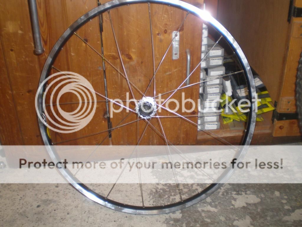

Lacing.
Dip the spokes you have picked in 3 in 1 oil or linseed oil. I use 3 in 1 it works.
Start like this on the DS.
this is for 3x lacing. the heads in spoke is 7 hole to the right of the heads out spoke.
The heads out spoke goes to the rim hole to the left of the valve hole.
The heads in spoke goes to the rim hole two holes to the right of the valve hole.
Now place all the other heads out spokes in the DS flange.
The heads out spoke to the right of the first one get interlaced with the head in spoke and goes to the rim 4 holes to the right of where you put the first spoke (one hole to the left of the valve hole.
Now place each of the heads out spoke 4 holes to the right of the last each time screw a nipple on.
Now place all the heads in spokes in the DS flange.
Take the spoke to the right of the first heads in you did and take it to the rim 4 holes to the right and repeat for all the other spokes.
Every other rim hole should have a spoke in it.
The lacing method we are doing work for disc brake wheels and rim brake wheels. All my wheels are built this way so when I do a disc brake wheel I do not have to change the lacing method.
Now the first heads in spoke you placed two holes to the right of the valve hole will be two hole to the left no you turned the half built wheel the other way around. Trace it back to the hub. This is spoke 1.
To the right is spoke 2. Place a new spoke, heads out, in the NDS flange so that it hits the flange between spoke 1 and 2.
This spoke goes to the rim 1 hole to the left of the valve hole.
Place a heads in spoke 7 holes to the right and place this two holes to the right of the valve hole and screw nipples down.
Now place all the other heads out spokes the NDS flange and take the one to the right of the first and place 4 hole to the right in the rim and repeat until every 4th rim hole is empty.
Fill the remaining NDS flange holes with heads in spokes and take these to the rim and finish lacing.
Done.

Tensioning.
Front wheel tension 950N +/5% (anything more than 10% means you still have work to do)
Rear wheel DS tension 1200N +/-5% (anything more than 10% means you still have work to do)
Wind with the spoke nipple key all nipples until the tread is just covered and align all nipples. It is time to get a little fastidious.
Add turns the same number to each spoke. This build needed 4 until there was some tension. Then straighten the wheel out. Look for maximum wobble left and right. The spoke where the wobble is are pulling the rim in that direction so you can loosen those spokes of or tighten spokes on the other side. To decide look were the rim is vertically is it high or low. Low indicates tighten spokes opposite the the direction of the wobble. A high wobble means losening the spoke pulling the rim. A wobble to the DS for example that pull the rim up means loosening the offending DS spoke maybe two to let the rim move back into to line. Repeat until the wheel is straight.
Check the dishing. This is were a dishing stick make it easy but most of you will be doing this in a frame so it pointless explaining how the dishing stick work. Apply turns to the side of the wheel to pull the rim in the direction you need so it centred between the locknuts. Never assume the dishing will remain set check it through out the build process. Never assume anything with wheels.
Grasp pairs of spoke and squeeze hard to stretch them. Do three rounds of this around the wheel. The tension on each spoke will drop if you have done it right. Raise the tension to 75% of the final tension.
Grasp pairs of spokes again and place the hub axle on a piece of would and put pressure on the rim, not too much though as you do not want the the spoke to unload as that could damage the bearings. Doing this will remove any wind up and you will hear some pinging.
Check dishing and true wheel vertically and horizontally.
Truing vertically is easy. With a low spot you do not have enough tension so pick two spokes opposites sides and add tension. For a high spot (rim pulled towards the hub) remove tension from a pair of spokes opposite each other. In fact sometime you might have to do this for two pairs of spokes. It depends how long the high or low spot is.
Now even out the tensions. this is were the tension gauge come in handy. High tesnion spokes will be next to a low tension one. So even out tesnions in pairs. Add 1/2 a turn to one spoke means taking half a turn of it high neighbour. Do this on both sides of the wheel. If you have done it right the wheel will remain quite round and straight.
Stress relieve by grasping spokes and pacing the hub axle on your piece of wood and load.
Check dish, true wheel and check spoke tension and even out again if needed.
Raise tension to target value and grasp pairs of spokes and load rim while hub axle is on the piece of wood.
Check spoke tension and even out if necessary (only small adjustments should be needed). You only need tension even to about 5%. The wheel should be quite round and straight.
True until you are happy with it but do not try and so round that you introduce tension uneveness it is not worth it.
Grasp pairs of spokes and load rim. It will go out a bit. True the wheel and repeat this process until the wheel becomes stable. That is loading does not affect how true it is.
If you do it right your wheel will not go out of true on the first ride or on any ride unless to bend it.
If the wheel pings on the first ride you have not removed all the windup. You will know for next time.
There is no black art to this just methodical work. I will add more when I get chance.
