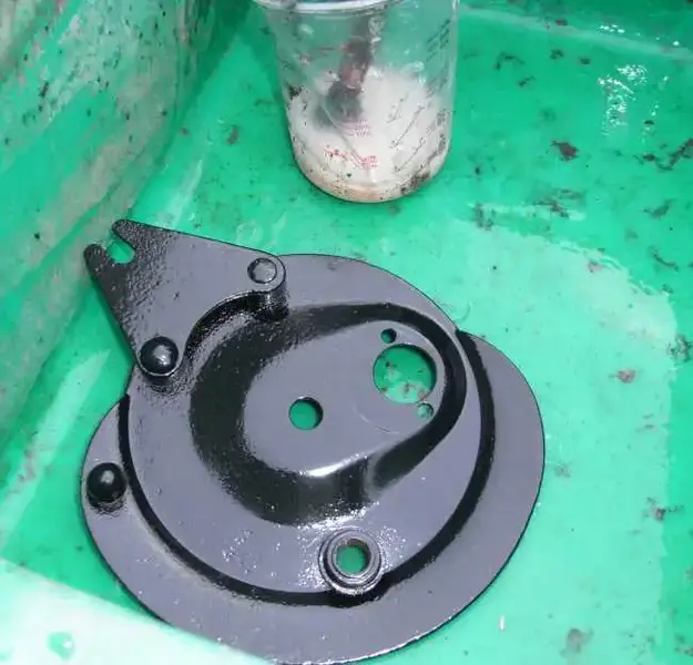

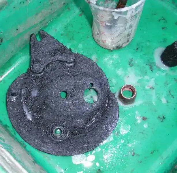

I strip powder quite often, I use paint stripper.
Coaters will probably have a bath of either some propriety
stripper or methylene chloride.
I just whack a nice thick layer of stripper on and keep the thing
well covered, in stripper, and the powder comes off.
Here's a pitted brake plate off of my bike, I thought I could live with what the coating would look like over the pitting, I couldn't, so I had to strip the coating off and redo it.
As you can see the stripper is OK on powder.
