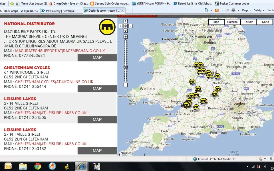

will911 wrote:
TOP POST....''an enquiry today to Magura UK and their response is, sorry we haven't parts any longer.''.
SO .. Guys ... Are there other service centres other than Derby..??? will
I meant find a service centre locally... not go to the H/Q where you know they can't help you :lol:
check out http://www.magura.com/en/bicyclecomp/de ... cator.html
Below is what it through up for me, so chuck your post code in and see what yah get
they've got to have someone in Ulster
PostPosted: Fri Oct 25, 2013 11:14 pm
Old School Hero
Joined: Wed Jul 27, 2011 10:13 pm
Posts: 223
Location: ulster
Not that i'm aware of at present..
