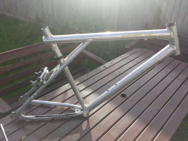

afternoon all,
i gave up cycling about 15 years ago, last trials bike being a vario tibo xl, that cos me a fotune, but cars, bikes and woemen started to get in the way so sold up,
whilst sorting out the loft last week i found an old zaskar e frame up there,
i remember purchasing it many years back with the intent of building it up and a road/xc toy, but never got round to it,
im gonna stick it up for sale, but would jus like to confirm that its a zaskar le frame before doing so,
few pictures below,
frame measures 20" from centre of bb tube to the lower weld on the top bar,
cheer for your help people,
mike

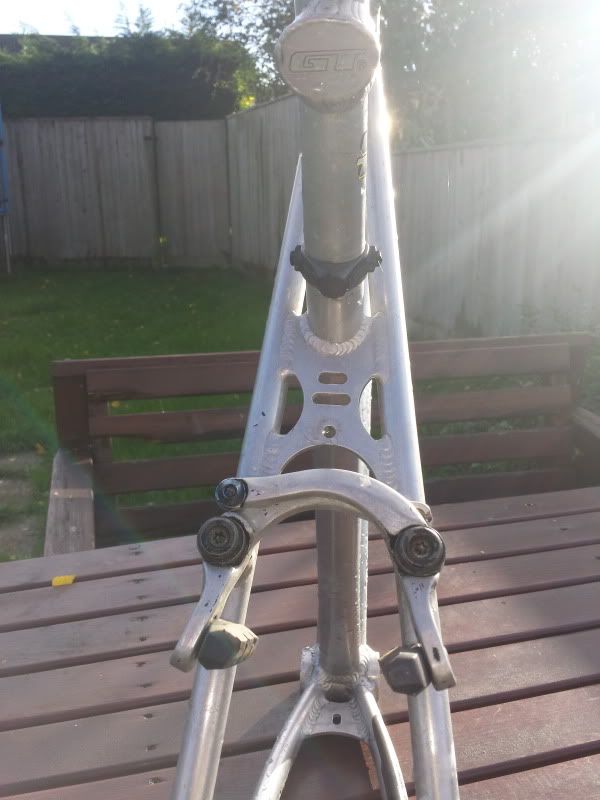

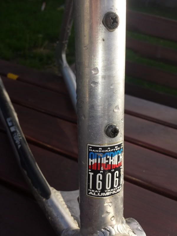

Flat end cap says definately a Zaskar, U brake suggests 1991 or 1992, looks in good wrap, needs a polish though, polish it and build it, get the bug back again!

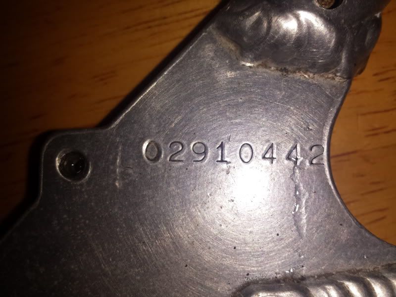

Frame number indicates it was made in February 1991- 0291*****

"LE" was just the spec on the bike I believe
Without a doubt a Zaskar frame :D

Unless my pixels deceive me, it has no mech hanger? This could be a bit of a faff to sort.

Not claimin' to be an expert :) , but didn't the LE frames have those replaceable derailleur hangers..?
BETD sell replacement hangers for most GT frames, including these.
