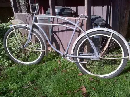

But I haven't too much experience with building these bikes... I saw some threads on here about restoring some older (1936/38) cruiser bikes to a klunker and some more pics of nicely done cruiser bikes but for starters: I don't even know what size frame to look for? I'm around 1.74m height and I guess I wanna use a 26" tire size frame. So would I just try and get a cheap Schwinn Cruiser frame and have it powder coated matte black or grey as in the pic below and start putting parts on it? Rear spacing would be a problem but I understand you can relatively easily change that (or not, and that's the reason most are SS?).

Thanks for the replies guys, I got some ideas and picked up a Schwinn Classic Cruiser frame today (1996 but it will do) and a Shimano Nexus 8 speed wheelset with roller brakes and wide creme white rims. So the base is there, now on to getting the frame blasted and powdercoated and finding parts :-)

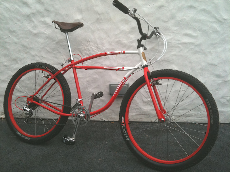

hi
i picked this one up on the weekend.
going to try my hand at one.
roy
