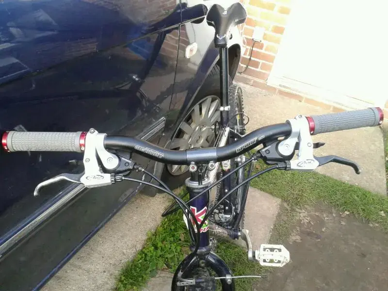

Now these are in
And these arrived today. What's a boy to do
