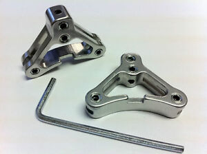

I always preferred the triangular hangers like the large cheezy one shows above. Easy to adjust and quite nice to look at.

Ringle Mojo (expensive), Avid Tri Dangle
I have never used the Onza Chill Pill but they look cool and not expensive

I like the look of the Paul Components moon units and they come in lots of colours !
