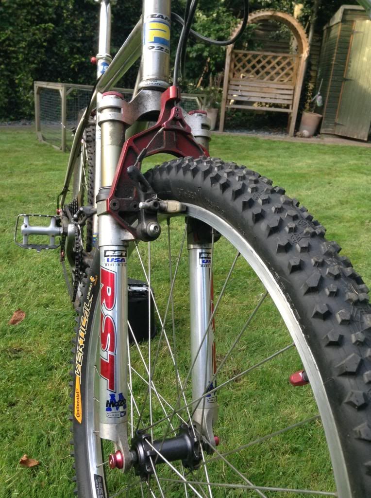

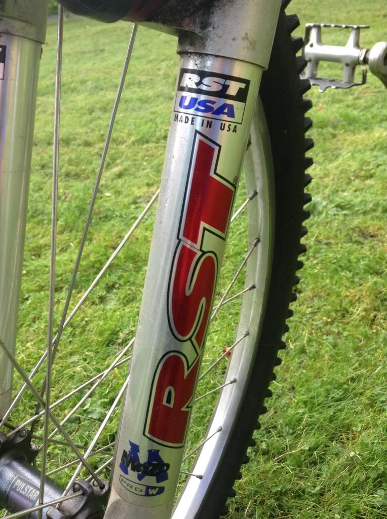

I have a set of the above shocks on a bike I picked up yesterday, I think they look the biz & from what I can gather, back in the day they weren't a bad shock. However............
The above two pictures show you what they look like....

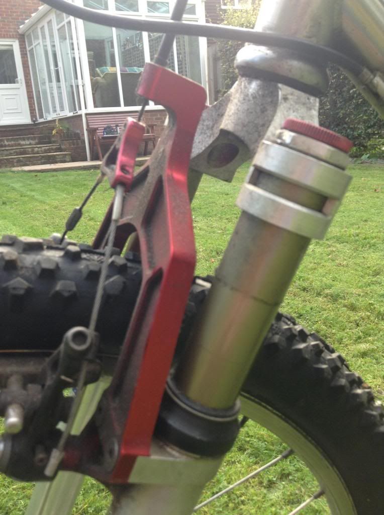

The problem is there is no rebound at all, this is a picture of what they should look like.......
But this is a picture of how they actually sit......
As you can see there is no resistance in the legs of the shock to make them work at all.
Is this an easy fix? Could someone tell me if they are air compressed? Elastomer? Or Sprung?
Does anyone know someone who could refurbish these for me (I live in the South East London area)? As I would love to keep them on the bike. I know absolutely nothing about these shocks the insides etc, but I do like them so any help / advice would be much appreciated.
PS. adjusting the hard/soft at the tops of the forks makes absolutely no difference.

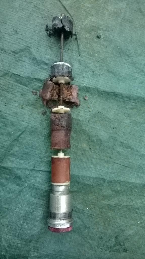

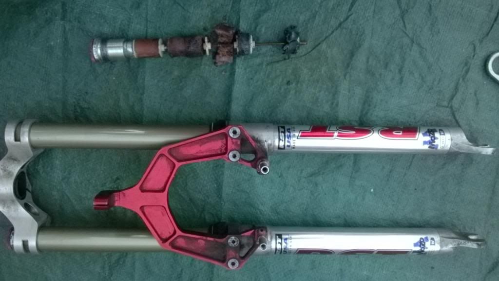

Finally got around to taking a look inside these shocks.......
Anybody got any ideas on how I can rescue these? I don't even know where you would go to try & get replacement elastomers / MCU's from? Even if I managed to get new MCU's, how do you get them on as the rod running through the middle of them seems to be fitted pretty securely into the top.

PostPosted: Fri Nov 18, 2016 12:03 pm
Joined: Tue Jun 25, 2013 10:47 am
Posts: 1010
You slide them off in "down" direction, buy new elastomeres (or some Spring that has roughly the right length and diameter instead). Silde the new ones on the rod, smear with grease (at the time one was called "Judy butter", nit sure what is used nowadays), fit into the fork and thats it.
That little black part at the End of the rods has to come off.

Trouble is where do you buy new elastomer's from in the UK?
 Post subject: Re:
PostPosted: Fri Nov 18, 2016 12:31 pm
Joined: Sun Sep 05, 2010 1:10 am
Posts: 4756
Location: Heathfield, East Sussex
If you can't find NOS elastomers/MCU's on ebay, go to Boots or a hardware shop and buy some of the rubber bungs used in 'home brew...'
They have a hole right through them and work a treat!
