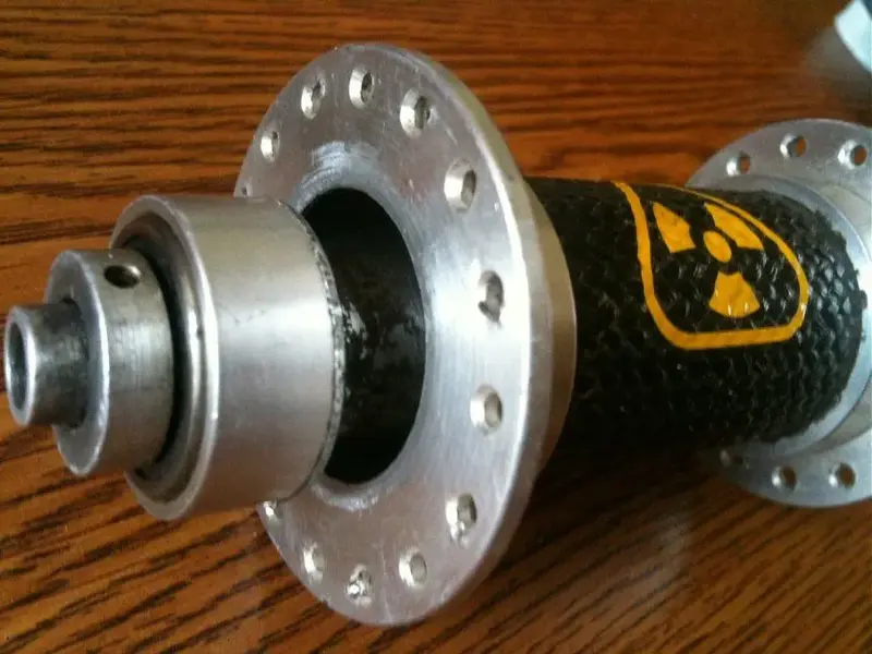

I've heard that Nuke Proof carbon hubs are prone to cracking. Think the particulars are it's the allow flanges cupping the carbon shell. Is this correct and does it hold true for the Nuke Proof ti hubs, as i believe they are the same construction aside from the substitution of the carbon with ti?

My carbon/allow front hub broke at the outer flange. Looking at the construction it's no wonder, there must be less than 1mm of material between the inside bearing bore and the spoke flanges.
Rear hub suffered a crack on the inside, allow sleeve cracked outward to the spoke flange.
I can post pics if anybody is interested.

Possibly, though I rode and raced mine for almost 20 years before they failed.
I will snap some pics

Pic now attached which shows the break pretty good I think.
Not much support material on these bearing flanges. Frustrating because it would have been very easy to taper the aluminum starting from the spoke holes down toward the outside ends. This would have increase the thickness in that area dramatically.

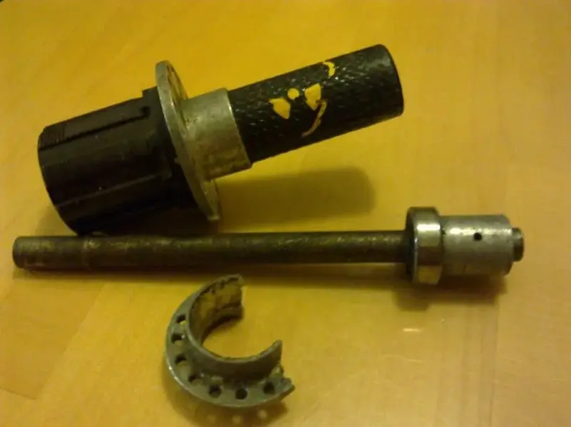

Had so many problems with the rear hub when they were new - the bearings used to collapse without much effort, and then eventually this:
