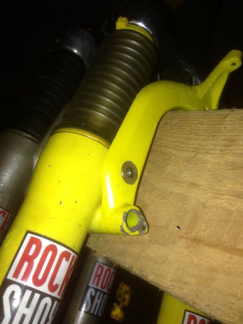

got a stuck brake arm on a fork stud any ideas or fixes?

The stud is off a pair of Judy's & it's come off with the brake arm and it just spins now

Cheers Ian but I think I'm gonna have to get a pic up

Pics up

I had to grind a flat surface on mine to get a suspension fork stud off. Luckily I had a spare.

Find a couple of nuts with the right thread, screw them on the back of the canti stud. Screw them securely against eachother (using 2 spanners) and they won't move anymore.
You can then put a spanner or a wrench on them (or mount them in a vice) to stop the canti stud from rotating while you unscrew the bolt on the other end of the brake booster.

Given that that looks like a titanium stud (and should be). I'd just use a mole wrench if I had one or try through the various pliers to grab the unthreaded part. Unsightly marks are not going to be seen.
