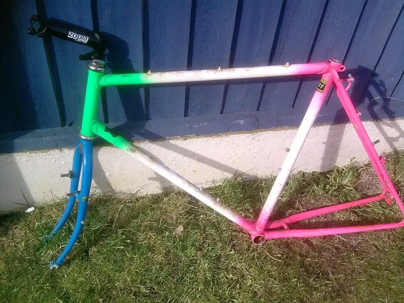

This frameset I've got is at least stickered up as having 501 forks, I bought the frameset in 95 / 96 from a local bike shoppe that was closing, and he used to sell the odd frameset, unbranded (apart from the tubing stickers) - like other bike shops.
Of course, there's no guarantee that just because the stickers have been put on the frame, that they are so, I guess same for the frame itself - the guy who ran the shop, though, was fairly well known as a cyclist and bike shop owner, and not the sort to either be that uniformed, or make out things to be something they're not. But all the same, I can accept that just because a frame has been labelled a certain way, doesn't mean for sure that it is all that's claimed. All the same, I'm fairly sure I've other forks stickered up as 501 - but I suppose two things apply - my addled memory, and the stickers being accurate.

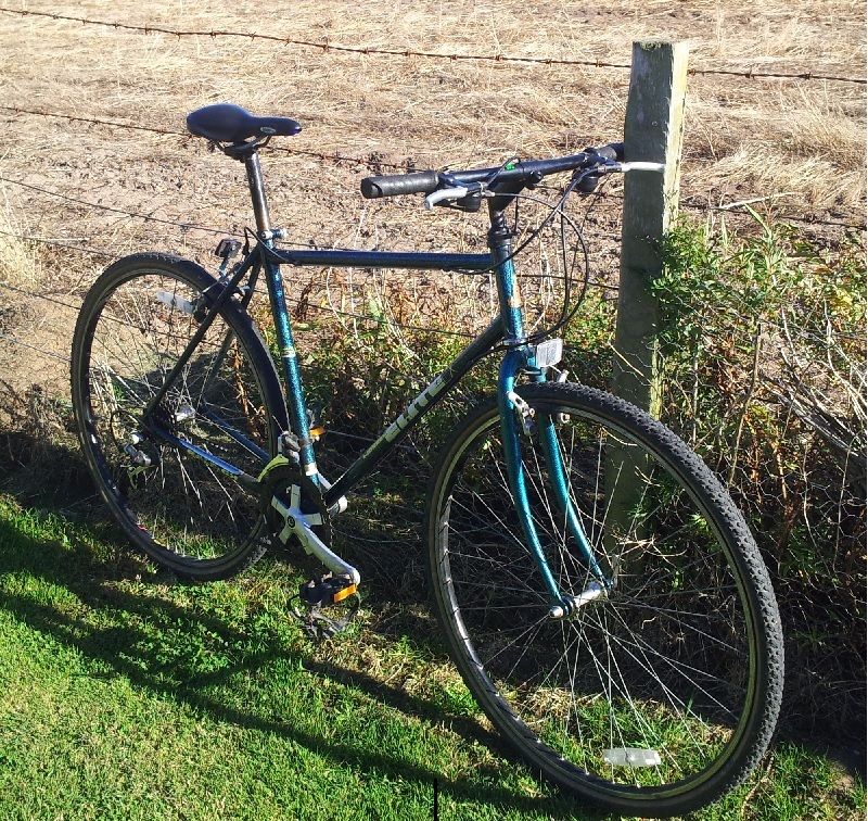

bikey:) : Your right on the money with that one. Heres mine
I think the 300LXCranks on that one are nicer then mine...at least you can change the chainrings when they wear out.
I had my suspicions the forks would not be 501, so would it just be the three main tubes in 501 and the rest ATT23 /18-23 steel? And are ATT23 as bad as some would have you believe Hi ten forks are.
Legrandfromage : your right about 1" 700c canti/V forks being a bit scarce, found a couple of new Raleigh branded Hi-ten ones around the £30 mark, the steeres about 10mm longer than my fork, could I use spacers in a threaded headset? There's a Surly Crosscheck cromo lugged fork with a 1" steerer on Wiggle which does look nice but is a bit more expensive at £67 and would need an aheadset fitted too.
I'm thinking of changing out the bars/levers/shifters and going with Midge dirt drops, drop bar levers and not sure what shifters yet, bar end, bodged thumbies with a stretched steel clamp or Ideally WTB mounts and XT thumbies and making a sort of roughstuff ish do it all, though it all depends on getting the Fork issue sorted.
Andy
