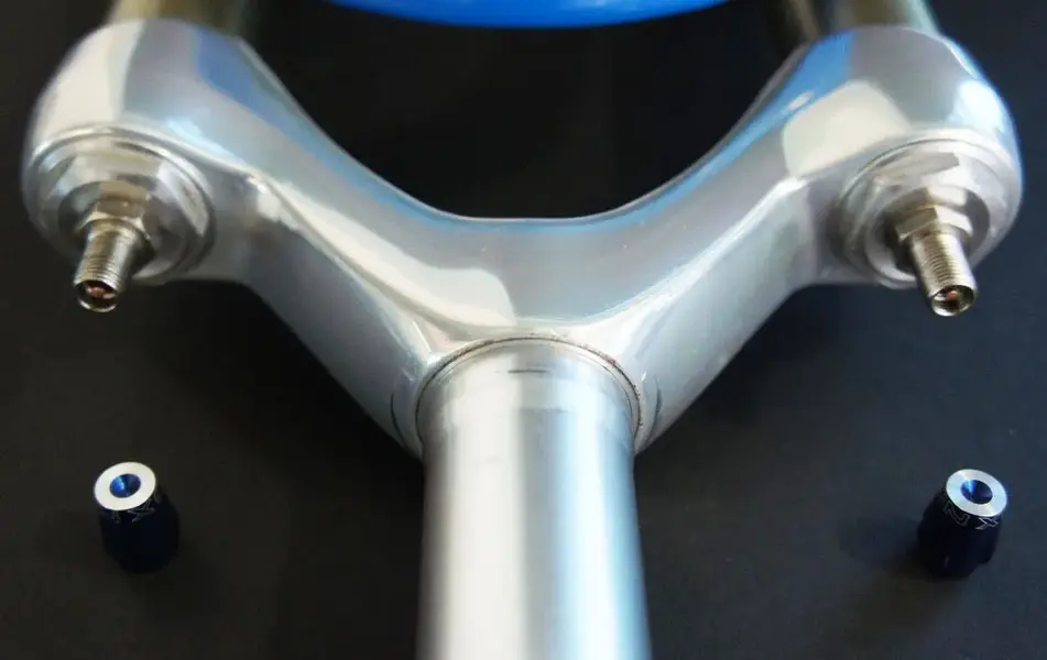

Depending on how original you want to keep your fork, you could retrofit it to proper Schrader valves. I have a '98 SID the first edition that had the stupid ball needle inflation valve, which of course was leaking air. A friend of mine got me two Schrader valves used on Oehlins air shocks. I drilled open the aluminum top caps and cut the specialty pipe thread in them. Put some Teflon tape around the valve threads, screw them in and voila: a fork that can be inflated with any shock pump on the market (hold air really well, haven't touched it in ca. 6 months, no air loss). The looks, well it's not original but with anodized aluminum valve stems it looks OK. I know I could have just bought aftermarket SID top caps with the schrader valves already built in, but I was too cheap to spend ca. 30$ per cap. (speaking of which I wonder if those said SID top caps have the same threading as the old Mag 21? In that case you could always switch them out).Here are some pics of how the FrankenValve would look like.

I've seen Mag 21's done that way, but on my bike at least, the Schraeders would strike the downtube should the bars be turned past 90. That'd probably destroy something... And like you say, I'd like to keep'em as original as possible.
I believe the Mag fork legs are rather smaller than the Judy family legs. Different threading. IIRC, 25.5mm vs 32mm?
Good ideas, though, and will be kept in my back pocket should RTV fail me. At least I don't need perfect valves, just something that leaks less than 5psi per minute, so I can get the screws in before the air's all out.

http://www.ebay.com/itm/Rare-Rock-Shox- ... 2581a30c3a
Right now on e-bay! Get those and you'll be good for a while. Don't know what your budget is but hose will be the easiest fix for your problem.
