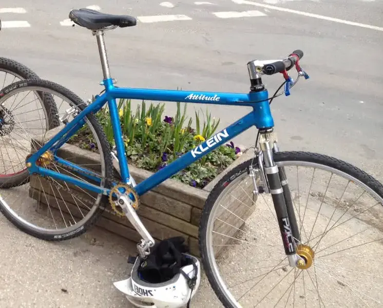

Here is my Klein Attitude with 700c - Fixie or SS - cyclo cross tyres - Onza brakes modified with longer bars on the cantilevers to reach the wheel - simple mod !

Looks nice. Any tyre/crown interface issues? Doesn't look like the forks would have to compress too far before there would be...
