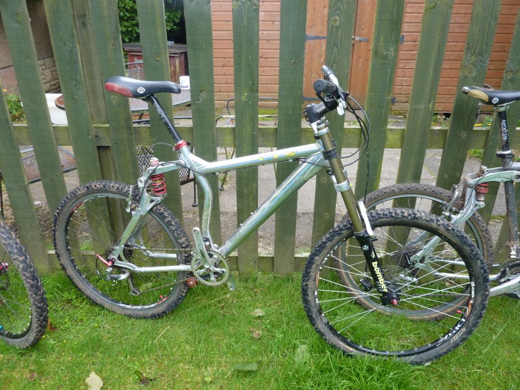

look for wear in the linkages, a full betd rebuild kit is nearly £200 although you can buy the bits separately. check for cracks where the bottom of the shock is bolted through the seatstay mounts, check the dropouts for cracking.
bear in mind these are bomb proof and will happily take most of anything you can throw at it just look for normal wear just dont forget the trunion mount shocks are becoming rare to replace so make sure the one you get is in good working order, risse do a replacement but it costs an arm and a leg and I think a canondale one works but if you can find a coupe deluxe original that is working then thats your best bet.
talk to ba7stards on here he is the lts expert
mine as a way of inspiration :D

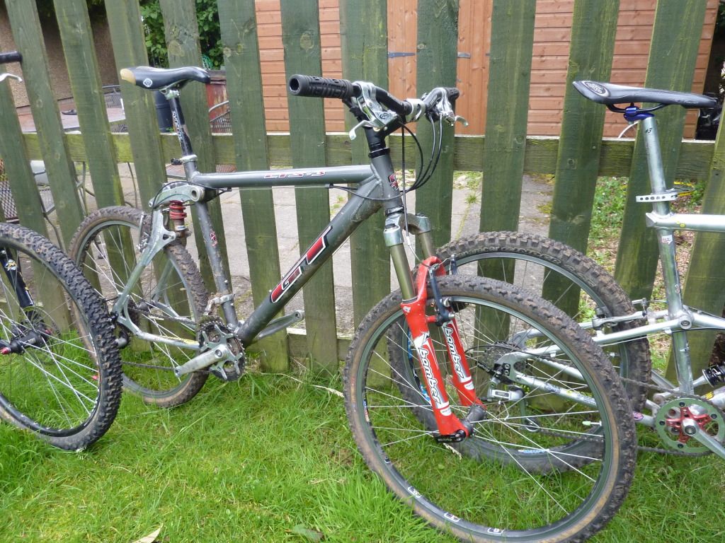

Their great ,, I have 3 of them
The dh models run big forks tho modern 120 ish travel forks work well ,means you can run a disc on the front easily , and on the rear with the right adapter
This lts3 is a still a very capable bike will fly over most stuff without flinching , not heavy either , these are probably the retro equivalents of all mountain or whatever it's called this week
If generalized hadn't enforced the Horst link patent I think this system would still be in GT's line up today in some form or other

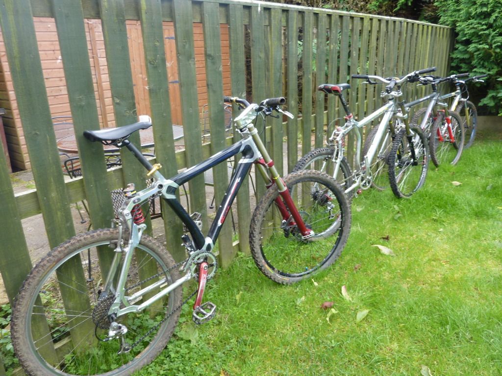

This an lts dh from 96 , was only available as a frame from the GT tech shop , there seems to loads about tho
Check the frame for cracks ,just have a good look all over , check the shock works ,and check the linkage bushes , tho betd do a bullet proof kit to sort it all out
I doubt if you'll be disappointed if you do buy one tho
