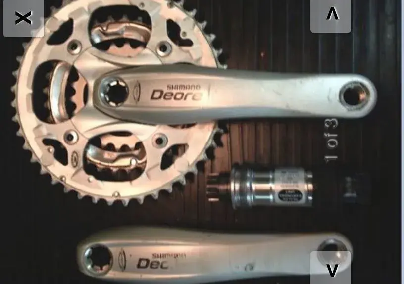

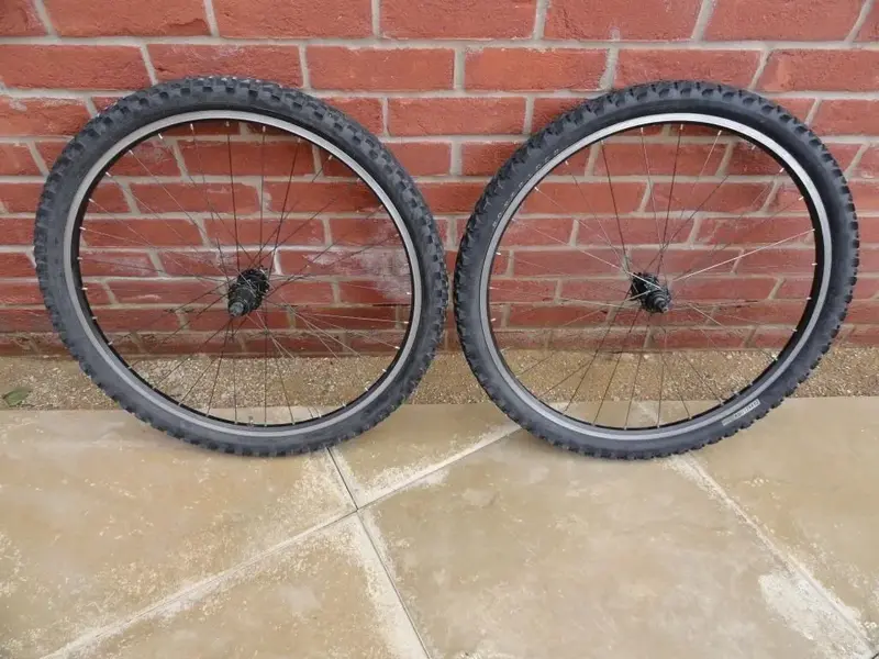

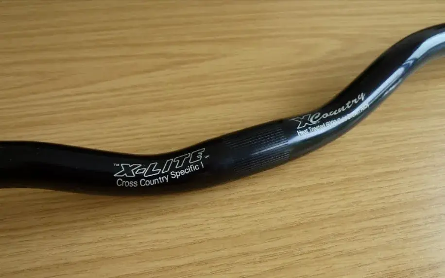

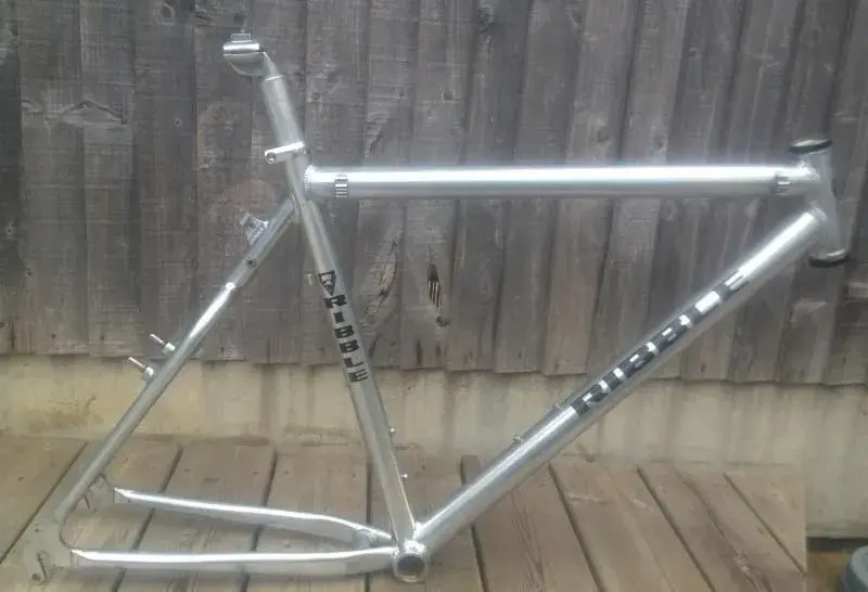

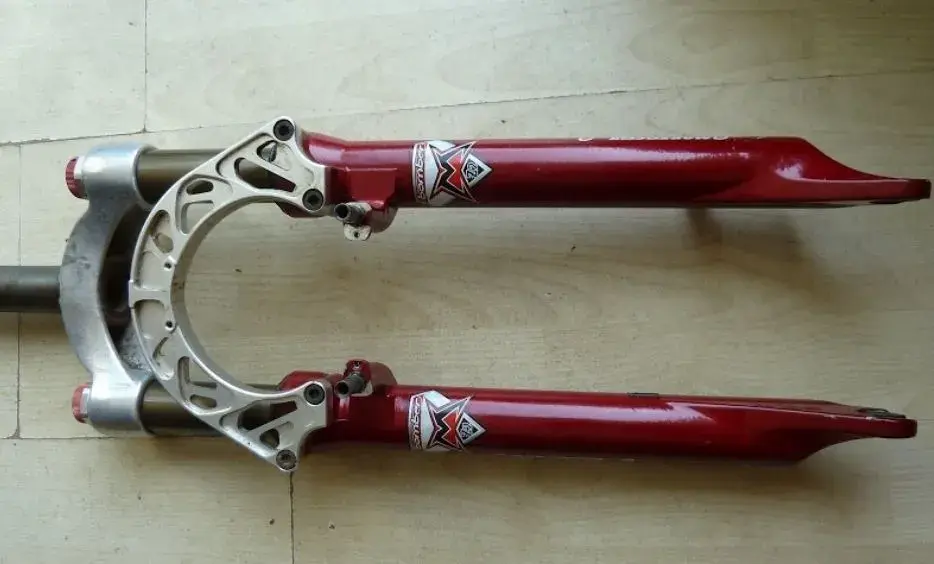

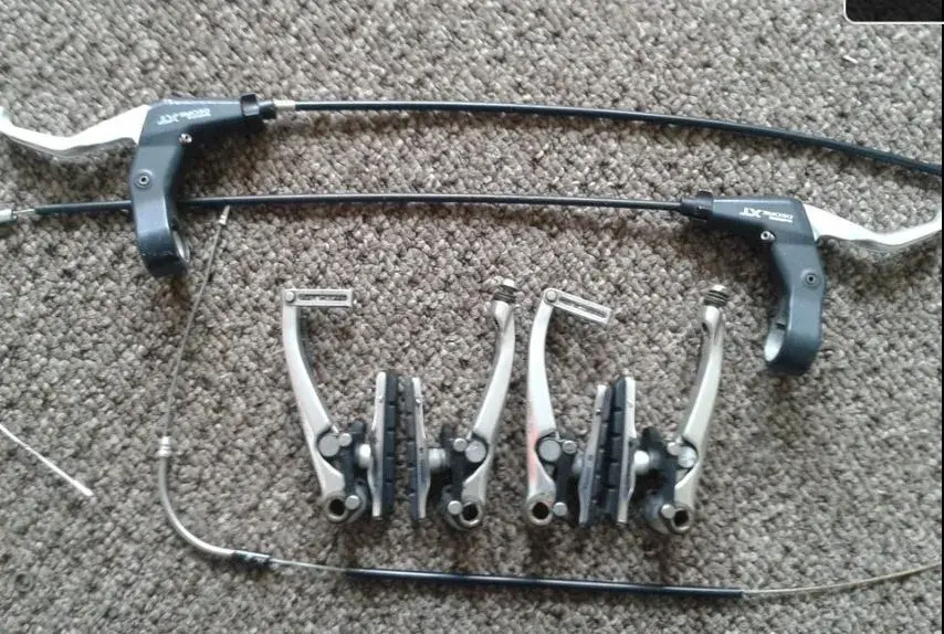

What is the difrance between the SGS and SG I know one in long and the over is short but what implications dose this have and witch shoud I buy that will go best with my other parts ??????
Ps: 9 speed
