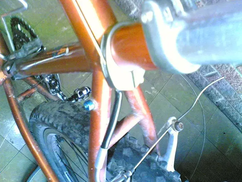

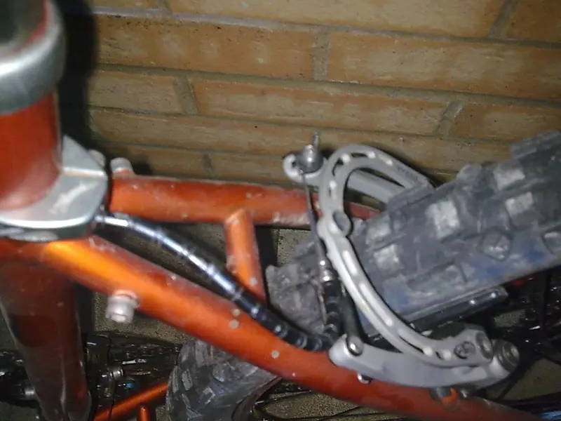

Avid do smaller noodles that might even make it work on a 17.
the orange bike is my old 18in lava dome - showing standard outer and nokon on an 18in frame
