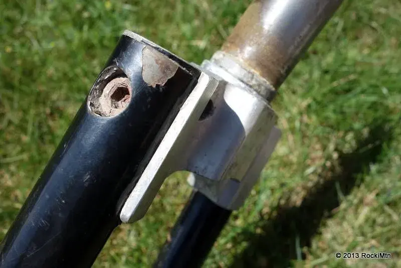

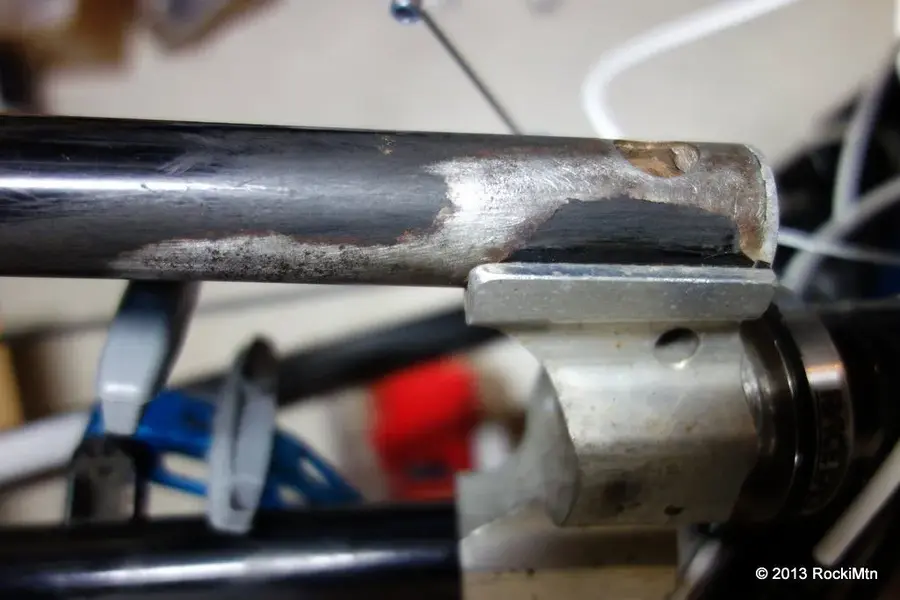

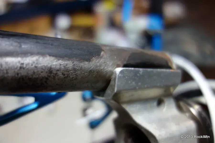

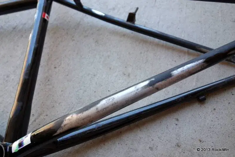

okay i'm trying to determine how to strip the finish off a 1993 Brodie Sovereign and an unknown year Gator Blade fork. i've sanded down some of the areas were there was signs of rust to determine if it's only surface rust. i don't fancy sanding down the entire frame/fork so i'd like to know if it's paint or powdercoated to do a chemically strip.
any thoughts/opinions given the following images?

PostPosted: Fri Aug 09, 2013 7:14 pm
Joined: Fri Sep 19, 2008 4:37 pm
Posts: 5211
Location: North West
My gut feeling = paint.
Based on the chips in the top left of the first picture.
WD :D
PostPosted: Sat Aug 10, 2013 7:47 pm
Joined: Thu Jul 26, 2012 1:31 pm
Posts: 2457
Location: The Cave of Shame
Ditto based on that fork chip
