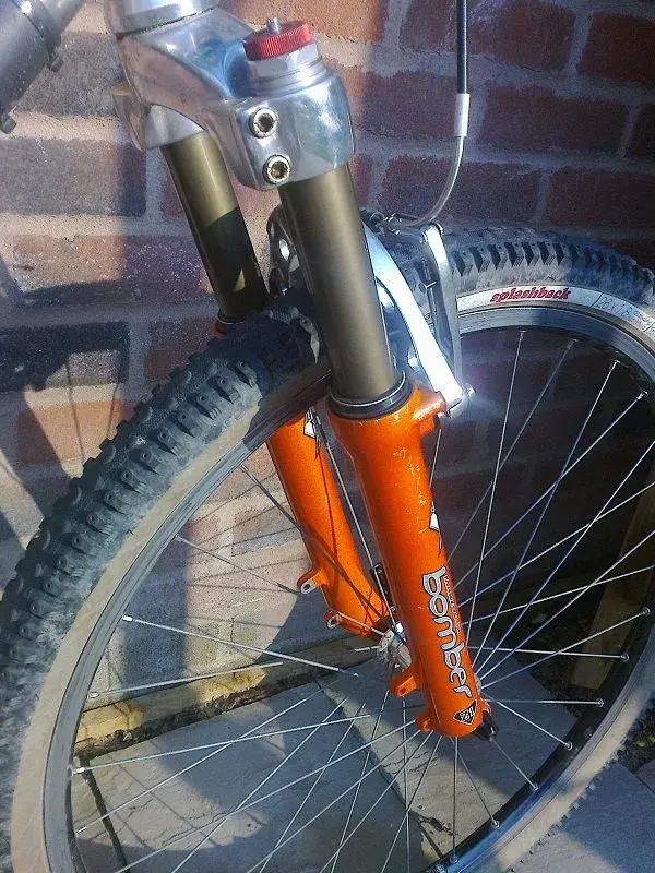

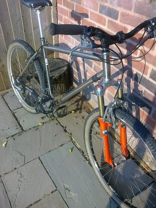

I have this machine that I recently put together and I absolutely love it. I think it may have a lot to do with the bombers. Only ever ridden rigid in anger before this.
I have a small problem with my forks though. There is a bit of flex between the inners/sliders(?) and the stanchions. This indicates worn internal bushings right? It has become more pronounced since a month of me riding it. I replaced all seals and oil before fitting the forks but left the old bushings in place. I could detect zero play once I had put them back together.
Being a novice at this kind of thing I'm here asking for advice. I'm thinking that I should strip them again and replace the bushings right? But would this also mean that I ruin the new seals I have just fitted?
Tips most welcome.
Matt

I would think you are correct. The Manual is still downloadable from the Marzocchi site http://www.marzocchi.com/template/listM ... p;idC=1592
It might be just me but your top caps/adjuster knobs do seem to be very high? do they clip the frame? (I noticed the zip tied band on the down tub)
Yes they do...But they stick out like that right? OK just checked the manual (thanks for the link). And they are too high! omg..
So it looks like I'll be buying a new set of everything and rebuilding then. It's all good practice I suppose. Thanks for the replies all.

off the top of my head, to rebuild the forks means screwing the top caps into the legs, the legs then fit into the crown, a circlip is fitted around the top cap (to stop the legs falling out) and thenn the crown bolts are tightened. Until you've done this I'd forget about bushings. This sort of play can be mistaken for headset play, or even the brakes rocking back and forth on the studs.

jitensha wrote:
66 triumph daytona wrote:
Well spotted there Matt.....
I did have to go in the garage and look at the set I have in there! :lol:
Mine seem to be different, but the crucial bit is the cir-clip that fits into a groove (in the nut on mine, but I notice no groove in your nut) is butted right up to the crown, not sat a few mm up from it.
Interesting point Alex makes about the headset.... worth checking first!
