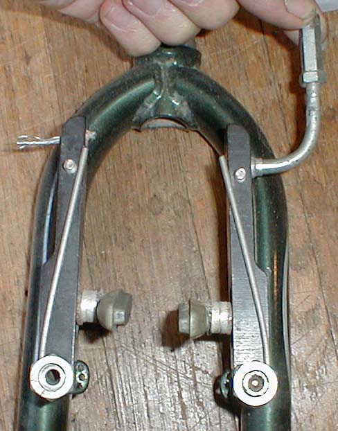

Seem to remember that the originals were made out of aluminium window channel. These were early, much earlier than 1996/7 - From Mombat http://mombat.org/MOMBAT/BikeHistoryPag ... ative.html :
How old where you when first showed brakes at Interbike? It was September 1989, I was 18.
There were other brakes that needed a long pull lever - like the IRD switchback. Just meant you had to run them close to the rim. They certainly weren't designed for V brake levers, just work better with!
