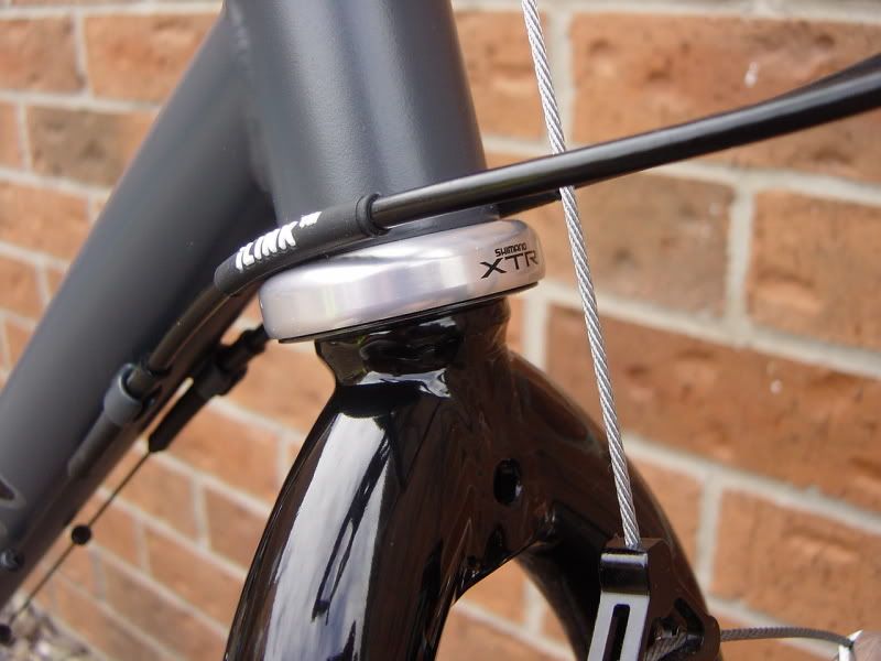

M900 could be had in both sizes :
WD :D

WD. Thanks for the info. But M900 on a rusty palisades beater might be a bit of a waste. On your BV it is majestic though, belated congratulations on a superb build.
