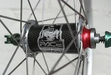

I am looking at this Pace hub from a fellow Retrower. Im wondering if the flange is about the same size so I could build it with the same spokes. Or should I just find another red Hope.

As for swapping to the pace hub, it'll only work with the existing spokes if the flanges and width from the centre line are very similar. Better bets to find another hope hub of the same type, someone on here will have one :wink:

I would put it down to bad luck I'm afraid. As for the Pace hub your best bet is to ask the seller to measure it for you and see how it compares to your Hope hub.

As I don't know the exact models involved here I can't say for sure but I'd estimate (using a couple of online spoke calculators) that you'll be short by about 5mm on there (assuming both are 3-cross) - a small difference in diameter on the hub flange can make a lot of difference to the spoke length.
http://leonard.io/edd/ <-- not used this one much myself
http://www.prowheelbuilder.com/spokelengthcalculator/ <--doesn't list Pace hubs but is the one I used to build up my wheels recently.
