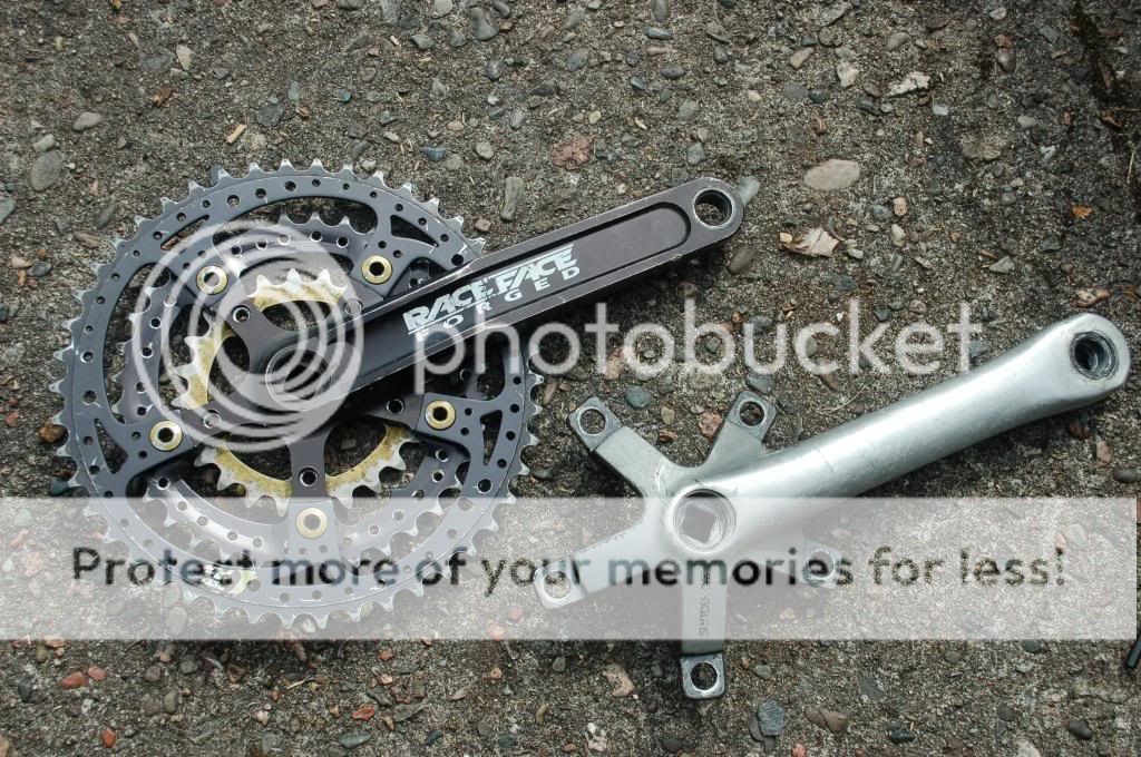

Piccys:
the cranks in question (sorry not sure which version of turbines)

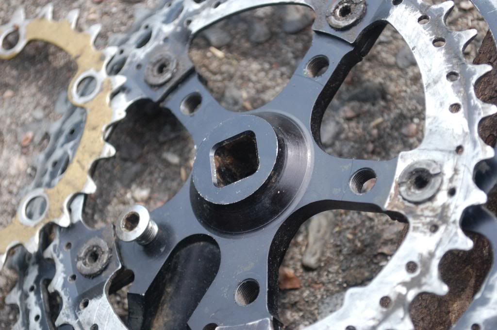

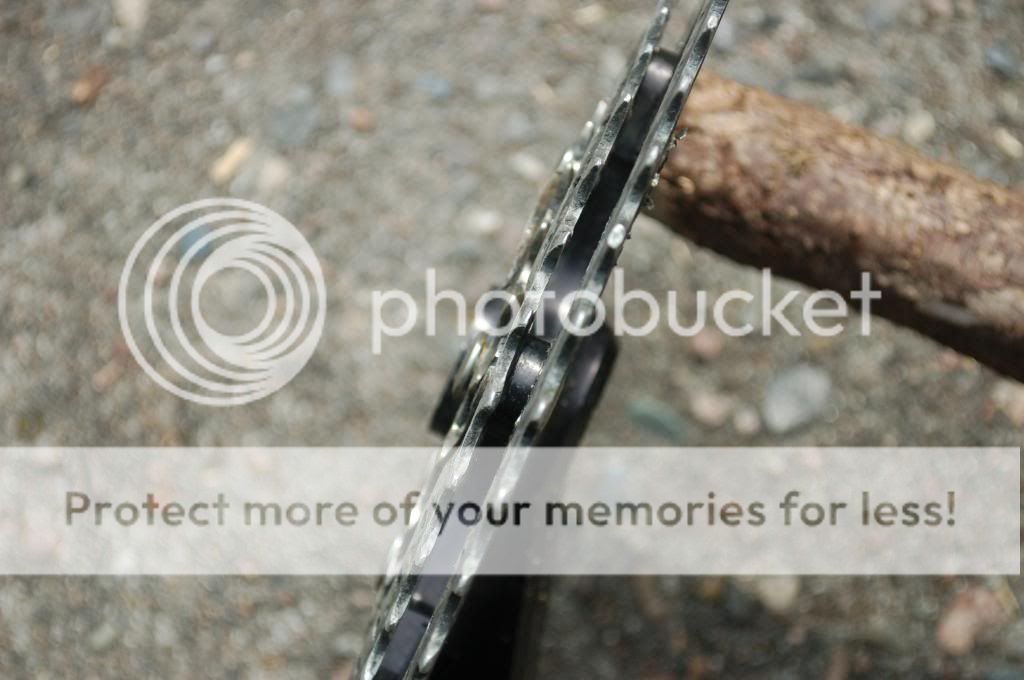

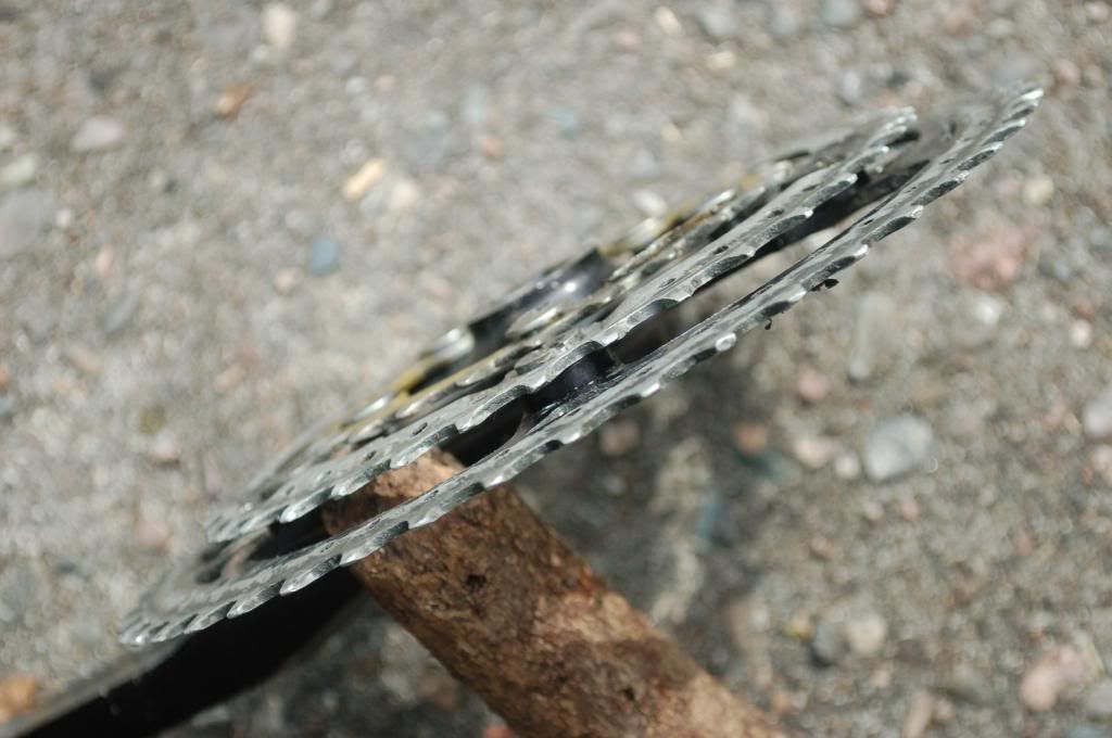

outer and middle rings look ok, but granny is squashed up against inner face of middle ring
granny bolts straight onto inner face of spider - I think this is where there should be spacer(s) or similar.......

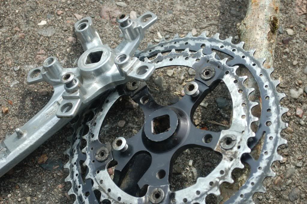

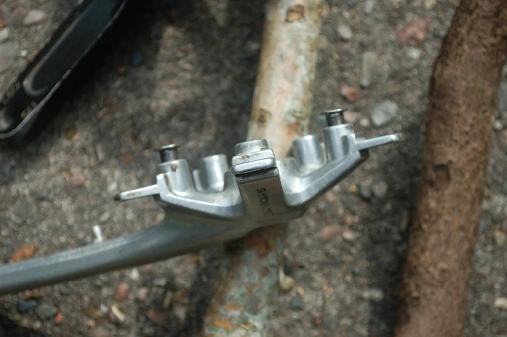

Suntour on the right has raised flanges on arms into which granny ring bolts go. RF doesn't.
Suntour.....All my other cranks appear to be similar in design to this

PostPosted: Mon Jul 08, 2013 6:19 pm
BoTM Winner / Gold Trader
Joined: Fri Feb 26, 2010 12:36 am
Posts: 4738
Location: Burlington, ON Canada
You need the longer 16mm bolts and the 8.3mm spacers (the 9mm I originally posted was measured w verniers on an assembled crank, and was approximate). On Shmoo/ST cranks the granny is already spaced out correctly via the raised mounting bosses.
