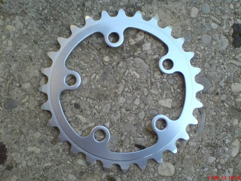

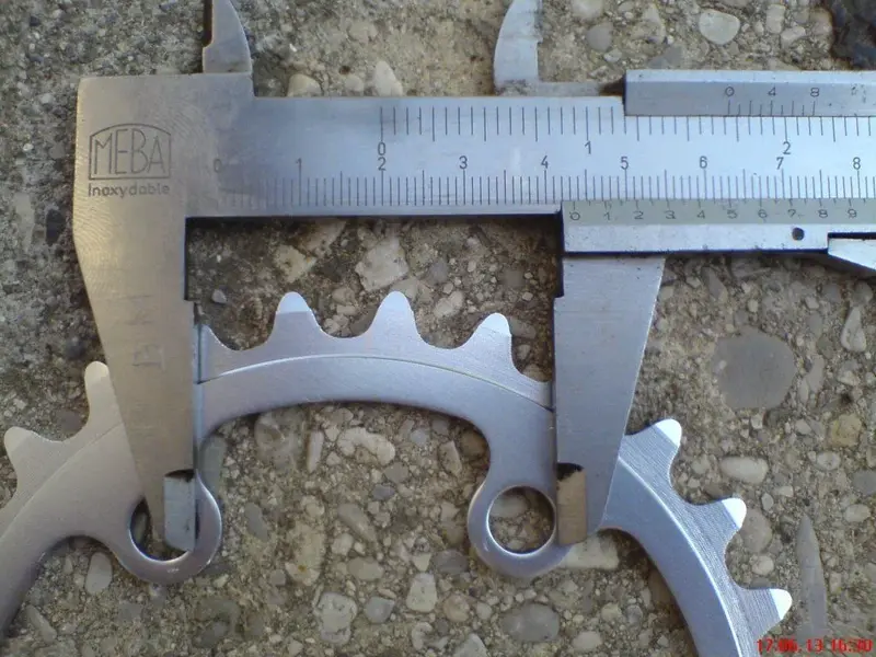

I have some 5 hole and different teeth chainrings. One of them (Sugino) is in the picture below. Distance between holes (as on the picture) is the same (between 43,2 - 43,4mm - can not measure better) on each of the rings, so I want to build a single speed crankset, where I can switch chainring.
I would like to know, what cranks should I look for? I prefer Shimano, since there are many arround. I think diameter of holes is arround 8,3mm, can check it up if needed.

That looks like a 74mm pcd ring, the inner of a 110/74 set.
You'll need something before 1993. However, as it fits in the inner you will need to chop off the mounting lugs for the outer two rings.
It's a VERY small chainring for anything other than trials. Chain tension will be high and you'll get through chainrings and sprockets fairly fast. Most people go for a ring in the 32-36T range, which also puts them on the shared outer lugs of the crank.
Trials bikes typically run 20-24T rings to gain ground clearance.

The chainring in your pic looks like a 28T inner chainring (Granny ring), it will be ok for going uphill, but not much else....
What size sprocket do you intend to run on the rear?
I run an 18T rear sprocket, so with the 38T up front it's just over the 2:1 ratio that is suggested as a good starting point for off-road singlespeeding.
