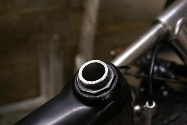

Hmmm...
So, I bung the football adapter from my Topeak track pump into my shock pump. Perfect.
One leg is perfect, the other doesn't appear to be holding air... Any suggestions? :facepalm:
I'm also wondering if the previous owner has buggered the steerer thread, I never expected a threaded aluminium steerer?

You do not get threaded Alu Steerers and for a good reason. The inner part would not be correct for a stem either ? They're thick things the alu steerers.
That's a self made job.
I can fix the air seal, but it cost a bit (and mainly bloody postage!)
Get some pictures up.

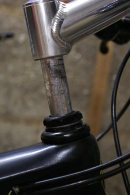

It's all a bit odd, Non? Very strangely, I honestly believe that it came from the factory this way, as;
1. The whole bike is factory standard
2. I've found a catalogue shot that it confirms it
3. The odd stem does indeed have a very slim er, shank?
But the top does indeed look cut by hacksaw?
Hrrrrumph...

Well, it's a 1 & 1/8 XT headset, the forks and stem are factory standard, and it's got a threaded alloy steerer??
The stem has 22.2 dia stamped on it, which I think makes it a stem for 1" steerers?
 Post subject: Re: Reviving Mag 21s?
PostPosted: Mon Jun 17, 2013 11:08 pm
Joined: Sat Mar 10, 2012 9:58 pm
Posts: 58
Location: IN/OH
Yep, intended for a 1" ..... If nothing else, that is a creative solution that I've not seen before.
