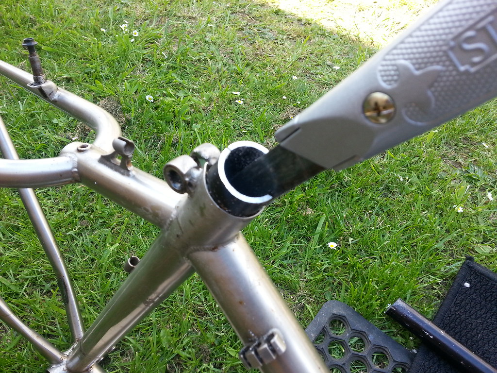

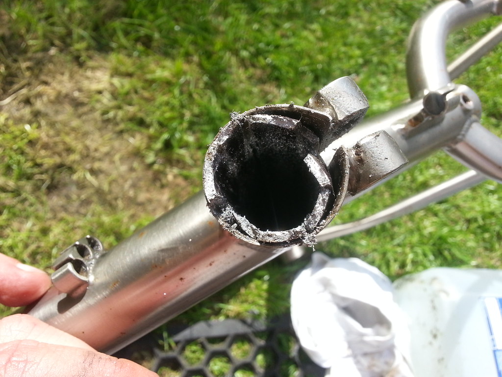

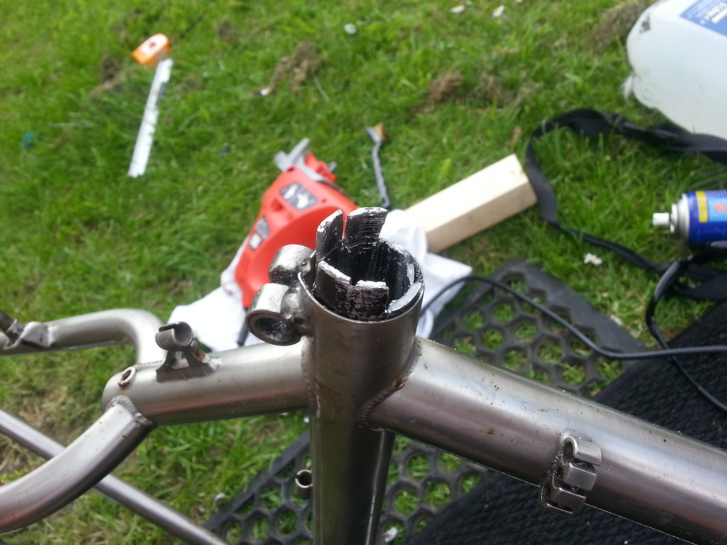

Bought this Orange P7 on ebay a few weeks ago, and was apparently all fine until I realised I had to drop the seat as was too high for me.
Unbeknown to me, or apparently the seller, the alloy seat post is properly corroded into the P7's steel tubing.
I have tried all known methods: basic turning of the post impossible; more forcefull approach with a vice also failed, even my bike shop was unable to make it move even half a mm; leave soaking in decent penetrating oil; pour in Coke plugging all holes with plasticine, use combo of heat and cold, general swearing and shouting, more brute force attempts etc.
Only thing didn't try was ammonia or Caustic Soda, although I did buy a bottle mostly because there is simply no cavity/space for any liquids to penetrate , so decided to leave these till the last stage which is cutting.
And that's where I am now, started off OK, but what you see in the photos literally took 8 hours of sawing and filing just to be able to peel back a few strips from the top. The real mare is that the post is about 5" down into the frame, so regular saw blades proving hard to get and reach the posts end.
I think in time, with more gentle sawing, open up a few more cavities, I can try the Coke and Caustic liquids again. If that fails then it's back to just more time consuming sawing and poking.
A few photographs to show the pain:

Looks like you are being careful with it anyway - keep patient and it'll be sorted out - the sense of joy when it's free and you clean it up and slip a new post in will be worth the pain!

I have to say I would have resorted to caustic soda before spending 8 hours sawing.
Now you've got that far with the sawing it seems a waste to switch to another method, but at the same time, if it's still going to be a few hours work I'd be tempted to react it with caustic soiad to get rid of it more easily.

i reckon you are wasting your time sawing and risk damaging the seat tube. put a bung in the frame and let the soda do the work for you.

Ah that will buff out, keep going your on the right track I had exactly the same issue in a Ti Merlin frame and a 400mm Thomson post that was in 3/4 of the way. Keep sawing and peeling back as you are doing. I'm sure you are but a long handle hacksaw with a long blade should reach down that far.
