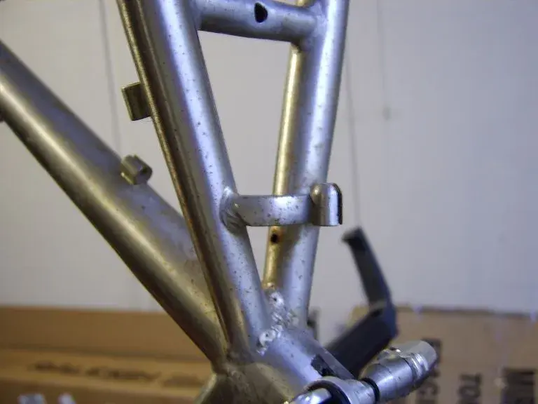

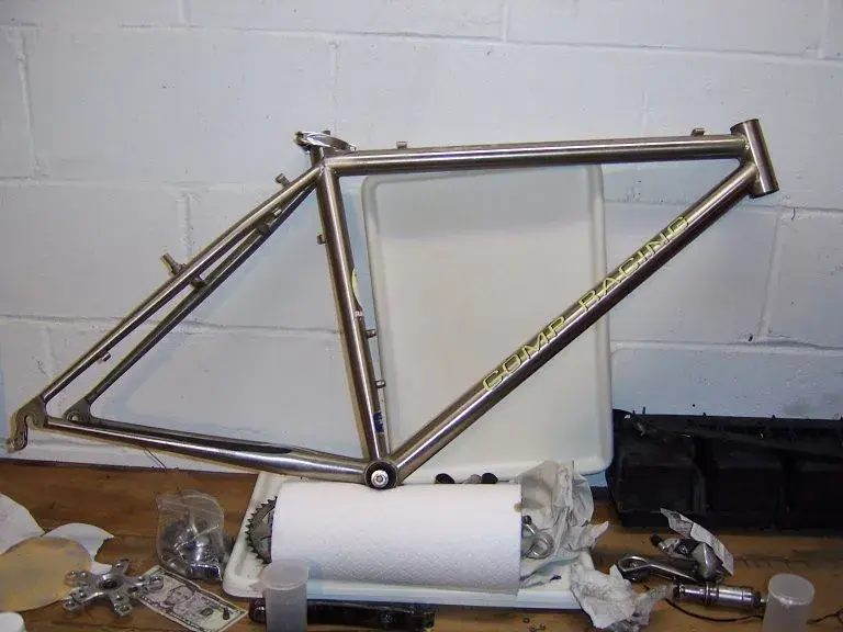

Here are a couple of pics .........
It actually looks pretty good from a distance, but when you get close up it has some issues.
Any suggestions?

Hi
If I remember well - Comp frames was chromed, then sticked decals (except size decal, and Tange decal), finished by clearcoat and sticked size decal and Tange decal
