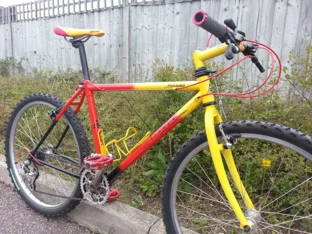

PostPosted: Mon May 13, 2013 5:35 pm
retrobike rider
retrobike rider
Joined: Sun Dec 18, 2011 10:42 pm
Posts: 2202
Location: milton keynes
Does it look like this
PostPosted: Mon May 13, 2013 8:28 pm
Joined: Thu Oct 07, 2010 10:32 pm
Posts: 443
Location: Hull, East Yorkshire
Apart from the seat stays are attached to the seat tube with capped ends and the two bottle bosses on the down tube, its very similar, as soon as I can I'll post some photos.
The forks are identical to these, even the colour is the same.
http://farm6.static.flickr.com/5141/564 ... 9b74_z.jpg
PostPosted: Mon May 13, 2013 8:36 pm
retrobike rider
retrobike rider
Joined: Fri Aug 08, 2008 2:36 pm
Posts: 17657
Location: Yorkshire, England
You'll probably not be able to tell between the various normal Tange tubings and the Prestige range of tubings. Ovalising at the bottom bracket was done on both, well at least in the turn of the 90's. But it would be the higher Tange versions if not Prestige.
Weight would be the normal give away. The Super Tubing range was not around to ~1992
Going before my time though.
I would guess that the 27 in the fork number would be the 1" JIS crown race size, Now obsolete as 26.4 is standard.
The other number would be an absolute guess at the length in cm :lol: though very long for a threaded.
