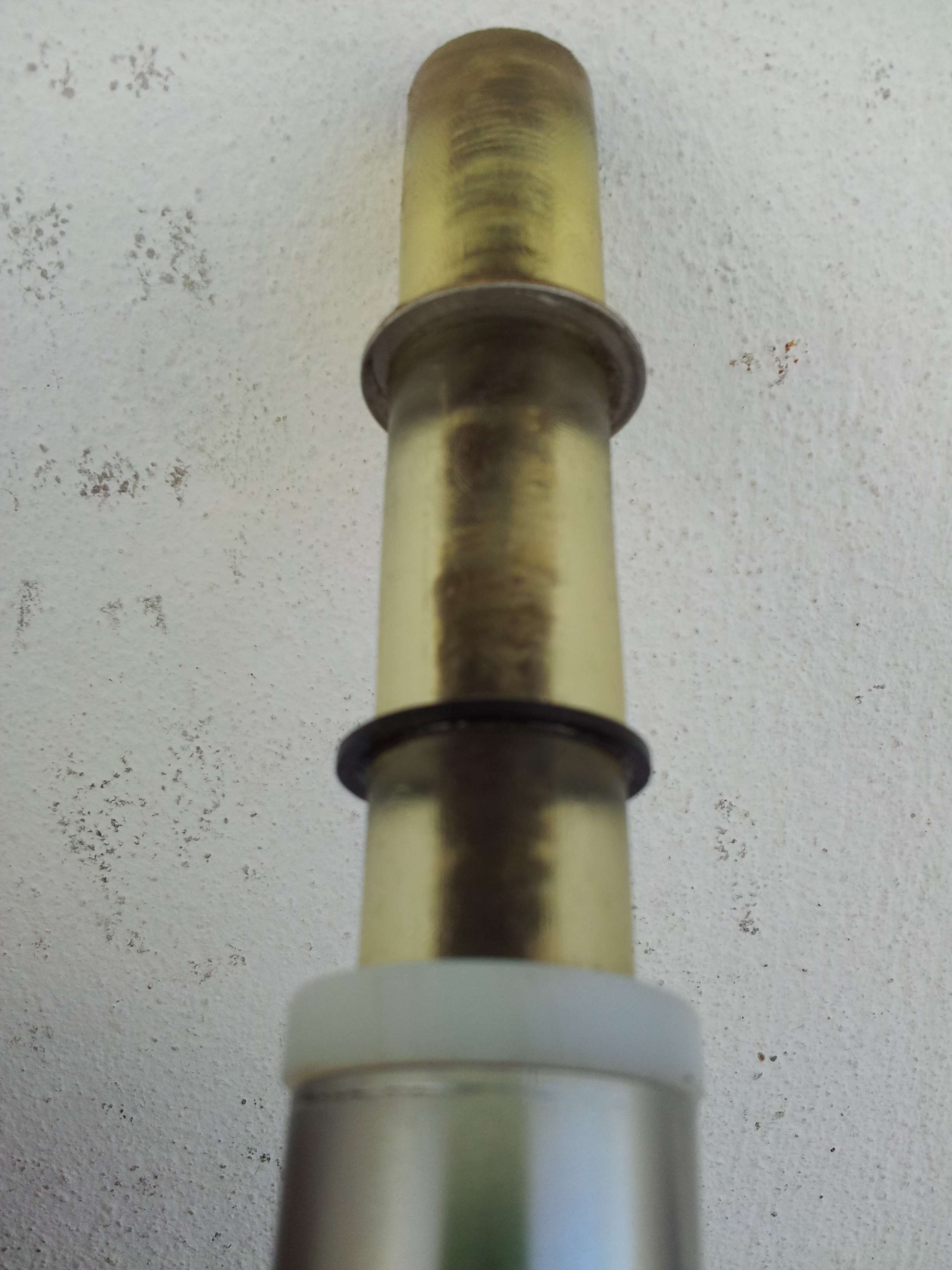

Hi there, I put the insiders of mine under a bath of WD40 for almost a week ...
Considered to put M Sport´s stanchions ...
Suspensionforkparts Manitou I refresh kit installed:

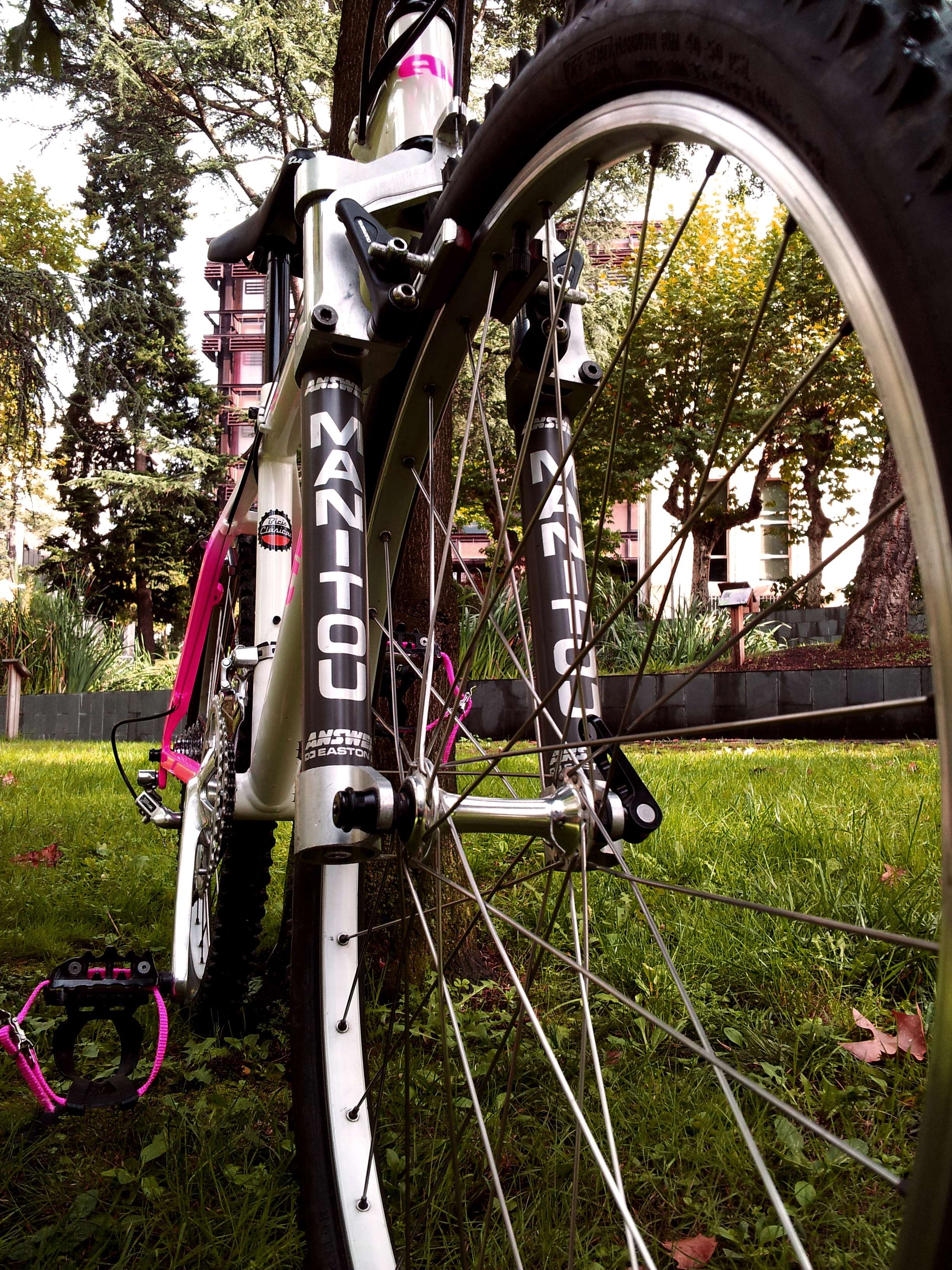

And the final result:
