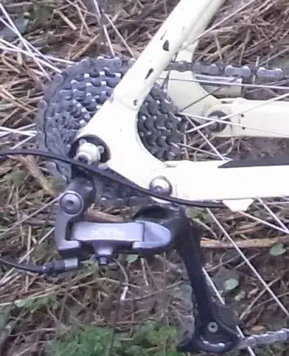

Hi all,
Just changed chain and should change he original rear 8 speed cassette on my 1997 muddy fox. Looking at available cassettes there seem to be lots of unexplained variables. HG41/50/51etc Have read up and am wondering how hard it is to do the job as my Haynes bike book says hardest job in their view?
Also will any universal tool do it or is it one specific one for each of above?
Would appreciate advice in which to buy as amazon seems good value/choice. Thanks in advance.

Not sure how this can be considered difficult at all. You need a chain whip and a cassette tool. Take wheel off bike, remove qr, for cassette tool through axle and I to the cassette lockring splines, wrap chain whip around the cassette cogs (there is a right way around, you need to be able to hold the cassette still with the chain whip whist unscrewing the cassette with the cassette tool), use the cassette tool to unscrew the lockring. Job done.

Exactly as ishaw says, just to add if you need tools or parts just search ebay, you will get some bargains and you will soon be up and running, or find a LBS and see what they have, I got a chain whip and cassette tool fairly cheap. :)
Its really not to difficult just remember it unscrews opposite to the drive hence why you need a chainwhip to hold it whilst you undo the locking ring :) and watch for your knuckles take your time and its easy enough.

Thank you to all. Is a chain whip same as an old oil filter thing with a chain on it as I've got one of them somewhere..?
Just been out counting and my current one is 11/28 and says shimano hg hyperglide c lock 40 nm so presumably I need to torque it when fitting?
Apologies if I'm being a bi of a wimp but bike book gives it 5 spanners :oops:

it's the same concept as an oil filter wrench, but generally a bit tougher
I use SRAM Pg850. better quality than HG50 and no more expensive

you don't need a chain whip - I use a short length of old chain, wrapped round the smallest sprocket and then use a pair of water pump pliers to hold the sprocket from moving - the chain is there to protect the sprocket's teeth.
