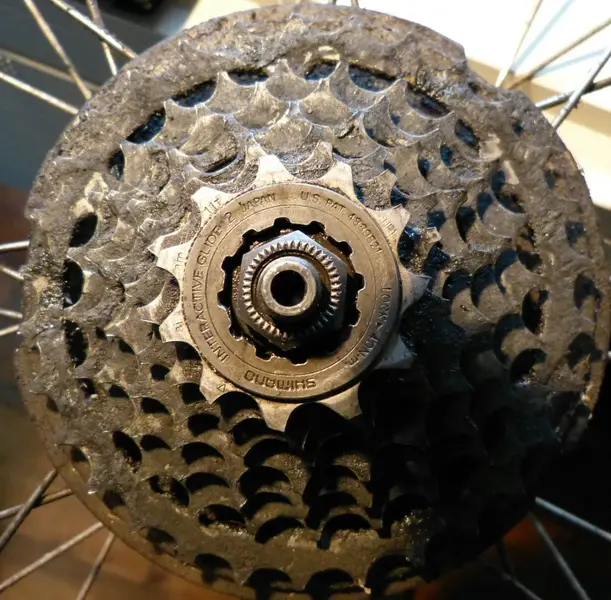

Hi, I've been lurking here for a while and now I need help!
My trusty Zaskar which I've owned from new has finally eaten through it's rear rim so I need to change/repair the wheel. The bike is in semi retirement and used when I need a bike that I can put on my shoulder for coastal path steps and other obstructions or when my 29er is broken, which is too often (like now), so I was contemplating maybe a second hand replacement wheel,(or two, the front's on it's last legs) But.... I don't really know what to look for new or S/H to get one that would fit. The cassette and freewheel are pretty worn, as are the chainset sprockets so Guess I need a wheel, cassette, freewheel and chainset that match, trouble is I don't know the parameters to consider in order to get it all to line up and work using the original Alivio 7 speed derailleur.
File comment: Shimano Acera-X FH-M290 Cassette Freehub and I.G. cassette

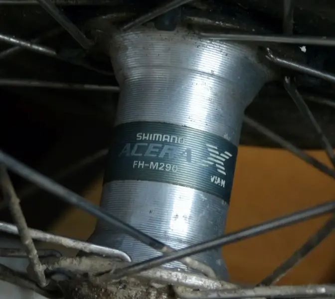

File comment: acera x hub FH-M290

If you just want it fixed you'll be able to pick up a decent set of wheels with cassette on here for about £30 to £50 and a decent crankset should set you back £20 to £30. Stick a post up in the 'wanted' section and see the offers flood in. :D

Any modern rim brake wheelset will fit. All you have to do is get a 7speed cassette spacer to fill the extra space needed for 8/9 speed. Add in a cassette, chain and rings and you are in business again...all for under £100 if you buy secondhand wheels. You can get a new set of Deore / Mavic XM317 rim brake wheels for under £120 at CRC for example. Even with new bits you are talking under £200.
Bearing in mind that a new bike as capable and light as your Zaskar is going to set you back around £1200, I think it's a no-brainer.

The acera X hubs are pretty low rent, and your cassette looks pretty worn on some of the larger sprockets. I'd assume that chain and chainrings need replacing.
+1 to what hamster said

More importantly have you had this round end-capped, Acera equipped 'Zaskar' since new ?

I'd have to agree with the non zaskar comment, the gear fitted and with the rear end cap seem to give idea of a lower model with a zaskar stickers..happy to be proven wrong though
personally I would go lx/dx rebuild, xt if you want to spend a bit more and a good set of mavics should see you keep rolling and continue to enjoy it
